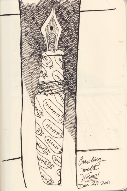

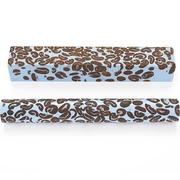

OKay - so I have no interest in making my own blanks. Well, I mean, I do, but I'd rather not get into that part of the hobby. Turning is going to take long enough to learn and get good at. But basically what I'm asking is - is it possible to cast little worms in a clear blank?
What I'm thinking would end up looking something like this...

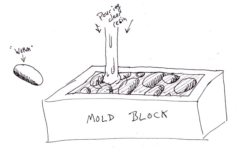

And then just for the fun of it...

Shouldn't be an issue. You'll most likely want to paint and cure your brass tubes first, then glue the little worm onto the painted tube using something like medium CA which should seal them onto the tube. Once you have them where you want them and the CA has cured I would pour thin CA over that to seal it all in again. From there you could use something like a resin saver for your brass tubes based on the kit. Heat your resin up to prevent bubbles if you don't want to invest in a pressure pot, pour and let it set. Be sure to let the CA gas off for a couple days before casting with PR or Alumilite.
I'm sure others will have a different take on this, but this has worked for me. I just put a Black Widow in some PR, but she was too big to put on a pen...I may use her on a modified cap for an ick factor...

Oh no! I'm sorry - I don't mean REAL worms. I mean making little green blobs that look like worms, and then casting all that in clear resin. Maybe make the worms individually then create the clear around them?
1. Yes it's possible to get a design like that, but probably not with actual cutworms. I would think that the moisture level would be too high. Polymer Clay come to mind.

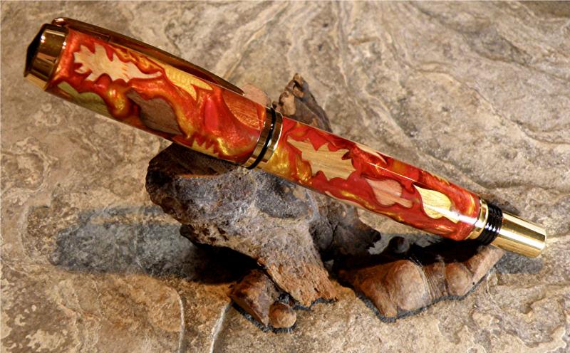

Give a shout out to Jeff Powell (workinforwood). He could definitely create a worm blank for you. I would think you are wanting the worms created from Alumilite, set onto the tubes and resin poured around them. This way you can still see the worms in all their glory. More like how he creates the Autum leaf blanks.

I think those would be too soft. The thing about making the worms one at a time from resin would mean they'd be easy to turn down with the rest of the blank. But like Jeff told me, it will be VERY time consuming to make this type of blank. He pointed me to the tutorial on his website, and I'll attempt it this summer hopefully.
