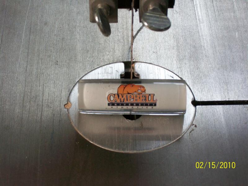

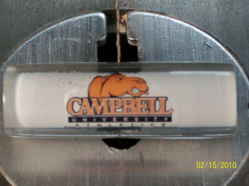

I do alot with decals and if you dont seal it it may run the colors. I experamented with the sealed decal on the tube and cast in PR and it worked great. Just make sure you have a way to prevent or reduce bubbles. Let me know if I can be of assistance.
Painted tube, sealed decal.

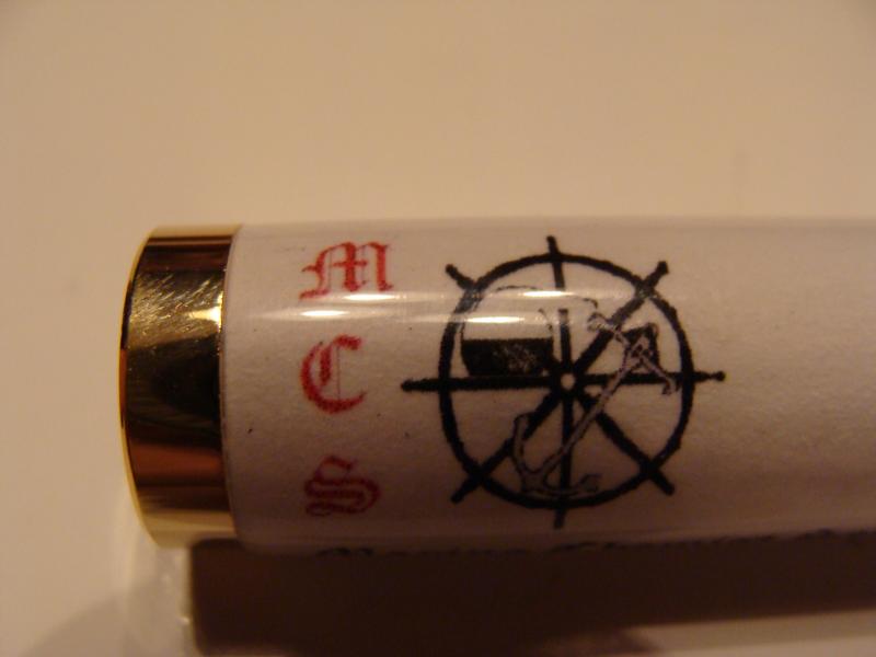

Labels....
I used an inkjet label for this Laser pointer. I sealed it with CA glue before casting..
