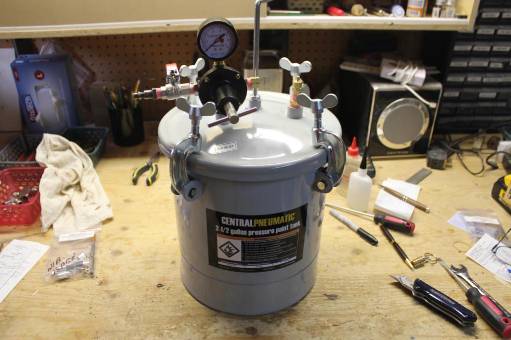

Here is my pressure pot, I stripped all the cheap fittings and installed new ones. I spent less the 20$ in fitting. After my 1st test, I had a pressure leak from the security valve, so I went back to stote and get a new one. Second test at 50psi and no leak after 12 hours.
Now I need to add a riser to the regulator kit.

Very nice pressure pot set up. I do have a question,, when you put the air in it, do you leave the air compressor on during the time the blank is inside the pot or do you remove the hose from the pot just after you put in the air? It's yet a little confusing. When I get mine set up I think I will get the good stuff to set it up with. I have been looking around. I just don't want to keep running to the hardware store if one little part doesn't work out. Thank you.. Fay

As I said, at my 1st test I had a leak at the safety valve that came with the pot. I have changed it and did a second test, I did not loose any pressure at 50 psi without the compressor running. I unconnected it from the pot.
Make sure you are using good Teflon tape, mine was the pink one, the one for high pressure and gas.

Hi Fay, If I'm reading your question correctly, most all air compressors will kick on when the pressure in the storage tank gets below a certain point, and will run until the pressure in the storage tank reaches a certain point. I have a very noisy little air compressor that will kick on most every time I'm putting pressure into my pressure pot.
I do not leave my pressure pot connected to the air hose. I put about 40 pounds in my pressure pot, then unhook the air and let things be for however long it needs to for what I'm casting. In the limited space I have, I'll usually relocate the pot to somewhere it's less likely to get knocked over.
FWIW, my pressure pot is the Harbor Freight one, and is very similar to the one that Jean-Pierre posted a picture of.
Hope this is a help to you. :)

I tossed the pressure cooker as soon as I found out that they are rated at a max of 10 psi, and some older ones were known to blow at less than that! (I saved the bottom and use it to hold parts for sorting...) I use the HF pot, and mine is a bugger to get a perfect seal on, so I leave the compressor connected with a pressure regulator set to 50psi, and it seems to work great.
I have 3 HF pots and each of them will hold 60 psi and not leak. I've left them for days with no leakage. You should find why yours leaks and fix the problem. If a large leak were to develop your compressor will run continously. And yes, this has happened.

Have you stripped all the cheap fittings that came with and replace with good one, also make sure you are using good Teflon tape, mine was the pink one, the one for high pressure and gas and I don't have any leak at 50psi after 12 hours.
