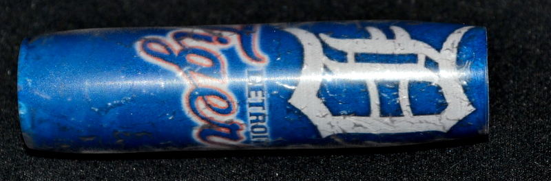

I'm experiamenting with casting tubes covered with water slide decals and have had some trouble with air bubbles forming along the tube, hopefully they show up in the photo. My process is:
1) print image on white waterslide decal.
2) let dry for an hour.
3) coat with three coats of polyurethane sprayed on from the can.
4) soak the decal in water for 30 seconds.
5) wrap decal around tube and wait 24 hours.
6) place in resinsaver mould.
7) heat silmar 41 for 5 cycles, add 4 drops of MEKP per ounce of resin.
8) slowly pour resin into mold and let sit overnight.
9) Remove from mould and use a barrell trimmer to square up the ends.
10) turn between centers on the lathe.
Now, I've cast bottle stoppers before and not had any air bubbles in my pours, so I don't think the problem is there. I think the problem is that the label isn't adhering to the tube tightly enough and when there is torque applied by turning it, there is some separation happening.
Tonight I wrapped two more tubes to try this again and I used the Micro Set solution that I bought with the waterslide decals...I thought before I tried to cast this set I would ask to see if anyone had any advice that might help me be more successful this time around.
Happy casting :)
Jim
I would use printed labels for wrapping tubes and leave the waterslide decals for application on the outside of your pens.
My rule is:
Wrap tubes...use labels
place on outside of finished pen...use waterslide decal
Although some may agree and some may disagree but this is what I do....I don't think the decal has enough holding power....
Jim,
From the picture I do not see air bubbles in the mix. What I see is a decal starting to melt from the casting heat. I tried casting decals last year and had nothing but failures. Maybe I was doing something wrong.
I would use the water slide decals outside of the resin, or under CA. But
probably not inside the resin. It tends to generate quite a bit of heat
All, thanks for the help...makes a lot of sense because the material of the water slide decal is a rubbery plastic.
Thanks for your help...I will try, try again with labels!!
