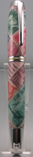

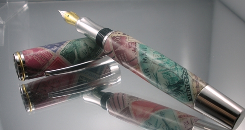

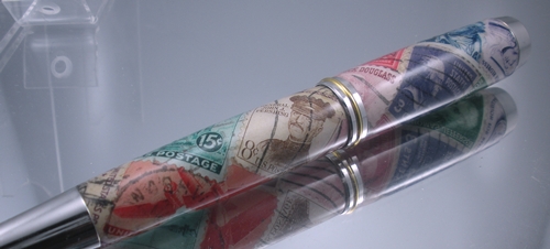

I wanted to make a pen with stamps for an uncle of mine that is a retired postman and has been an avid stamp collector most of his life. I tried printing stamps on my color printer and using those. I think it would work but I got some bleeding of the colors. I think with a little more practice I could do it right. I actually went through a bunch of sites on the internet and made me a sheet of stamps. Some rares ones. I made it into a powerpoint page and printed it and cut out the stamps. If you want to send me a private message with your email address I will email you the powerpoint document and you can print and use those stamps.
I went ahead and ordered the stamps and finally made a pen. You really need to cut the wood down well below the bushings. It takes at least 10 coats of CA to cover them smoothly. I think it is also important to cover them with a decopauge protectant before you CA them. Just put the first few coats on with out sanding and with little pressure. Once you have it built up then you can sand with micromesh to get it smooth and then go back to CA.
The pen I made turned out very nice, although the barrel is slightly proud of the finial, but the other three joints are fine.

That's a beautiful pen, Peter. I'm going to have to try that myself someday, my dad's been collecting stamps since he was a kid.
daniel
That is stunning, yowza! Thats the effect I am looking for...Thanks for all the help.
