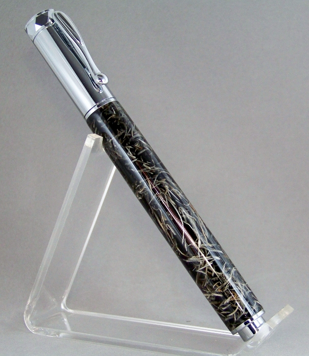

Q: Has anyone tried to cast this stuff? I use alumilite, and am aware of the issues with moisture, but I'm curious if there is any history with this yet. (Yes, I'll try this summer).

I tried casting some several years ago when I first got started and was casting everything that sat still long enough for me to get my hands on. I put some in red dye and then dried it in the toaster oven for a while. I used Silmar 41. I was shooting for a vein full of blood look and it cast ok but I didn't have enough moss in the cast and after revers painting black and turning, it appeared a bit empty so I put it aside and moved on. Hopefully you will have better luck!

Mark. It should cast just fine. Processing it to be dry enough to cast is the hardest part. Give it a try and see if you can do it first. If not and you REALLY want to make a moss blank. Go to hobby lobby and buy a bag of dried moss. It's just a couple bucks a bag and casts with ease.

Yea, I did think about the HL stuff. I've seen it. I got some from some trees to play with, so we'll see.
