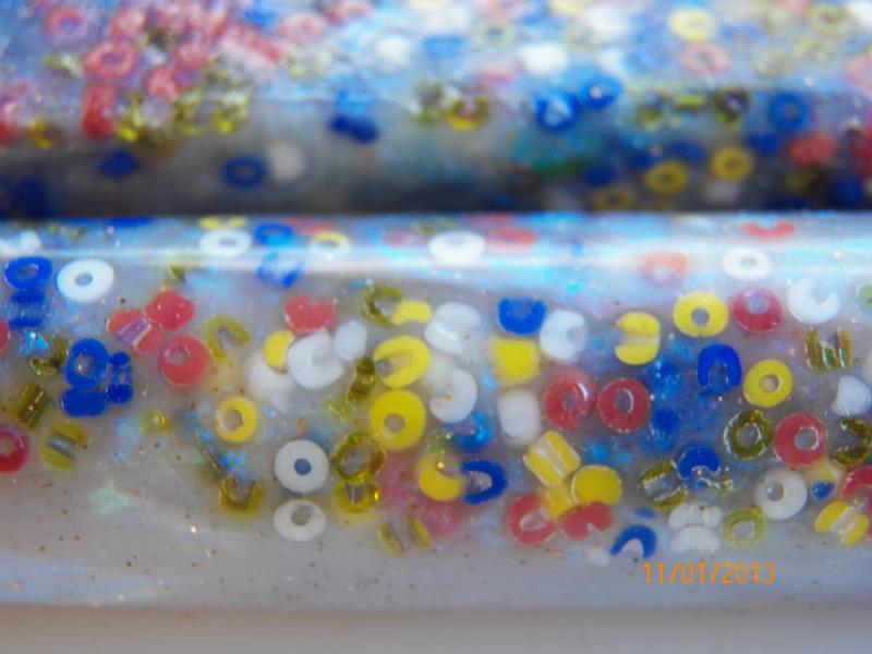

Apart from all this, it shouldn't be any harder than make a blank with GLASS beeds:eek: and then turn and finish it...! damn:eek::mad::biggrin:
