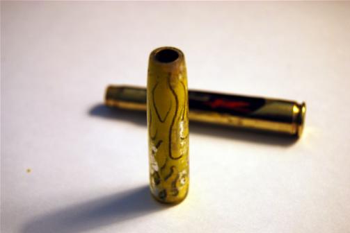

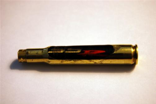

I have been trying to get a rock hard insert, inside a bullet but it comes out spongy and won't finish. I heat the bullet with a mini torch so that it is too hot to touch, pour the Allumite in and pressure it at 60 psi, then bake it in a toaster over at 150 degrees for thirty minutes. I am sure the mixture is 50/50. What is happening? I also continue to get air between the decal and the resin or Allumite. Help.
