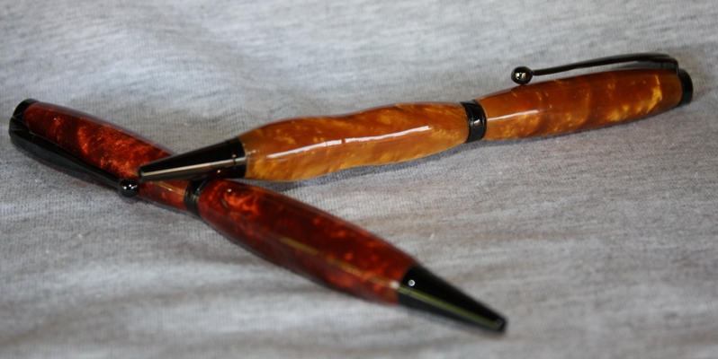

If you just want to get a feel for the process, go to your local big box home improvement store (Lowes, Home Depot, etc.). Get some 3M Fiberglass Resin and MEKP. Lot cheaper than Hobby Lobby or Michaels or even silmar41. It tends to work best with copper, silver, gold or brown tints as it is a brown color in the can. I use Pearlex powders for color and it comes out pretty nice.
This will let you get your feet wet without costing an arm and leg. Then, if you like it, you can move up in quality/price.
These two pens were cast this way and show a lot of color differences as you move them. The red one is copper and the other is antique gold.
Just a suggestion. Not sure it's worth $.02 but I'll pass it along anyway.:biggrin:
