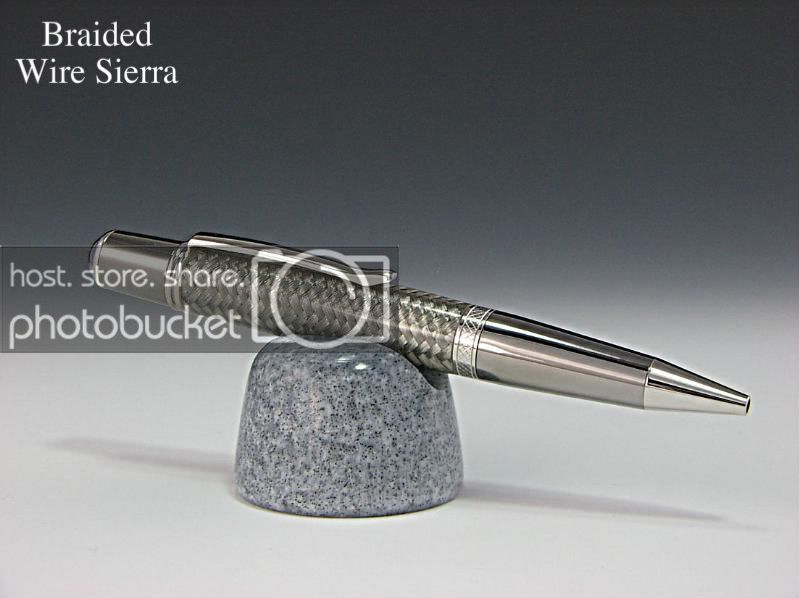

I use the dixie cups. They have a wax lining and when done just peel right off. You can get them cheap. My little prop was poured in one. Just one note and that is I use Similar41. That stuff does not heat up as much as such things as Craft-n-Cast resin.
