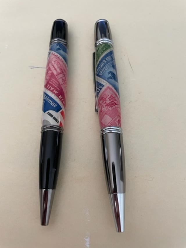

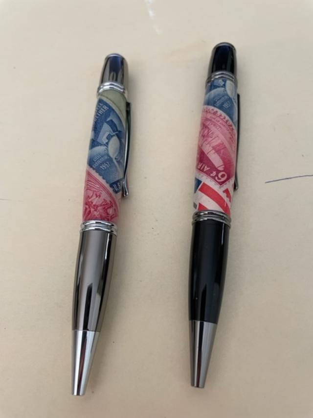

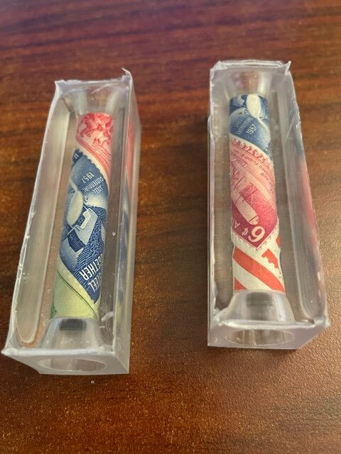

I followed your directions Kenny, and so far I am very pleased with the results. I removed the glue from the stamps, painted with 2 coats of white acrylic paint, adhered to the tube with Elmer's clear glue, and once dry, sealed the outside surface with 2 coats of the same Elmer's clear glue, making sure to cover the edges of the stamps and the ends of the tubes. These were cast in Alumilite slow inside a pressure pot. I have not turned yet, but I do not see any yellowing or bleed thru. Thanks for your suggestions!
I'm now trying the same method on images printed on plain computer paper, in lieu of using labels.
Glad I could help. They look good to me. I'd like to see the finished pens if you don't mind sharing those. Alumilite has a sealer that I use as well. They said it's a similar product as Mod Podge. It's white and dries clear and it dries really fast. Not to throw too much at you but I still use Elmers to glue up the tubes but I use the Alumilite Sealer to coat them to seal up everything. As far as the stamps and pictures go be careful when putting the final coat on not to trap air or cause bubbles along the edges. Once you cast a few you'll see how easy it is and wonder why you had all the initial issues.
I hope to get these turned this weekend and will post additional pics. Appreciate the heads up on the Alumilite Sealer. I didn't know that product existed, and will look into it.
