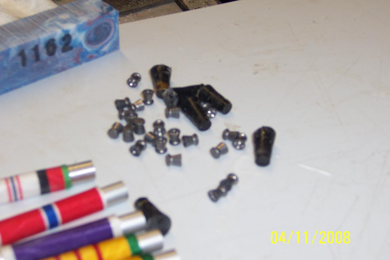

Locally, you can buy the rubber stoppers at Lowes, or Home Depot. I order mine from McMaster Carr in packages of 50. I think they are somewhere around $6.00.
