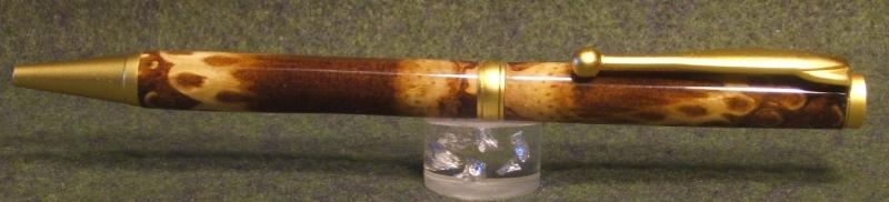

I do the same as John, I use longleaf pine cones. Personlly I like them better than the cast ones.jmho:wink:

So That is where those pines cones are. I have been looking from California to Texas for a worthwhile cone. Now I need to travel to Georgia. Thank you for the info. Your pens are beautiful. Much better than what I am able to accomplish. Mine are allot darker than yours. I like the light color of yours. I am in envy.

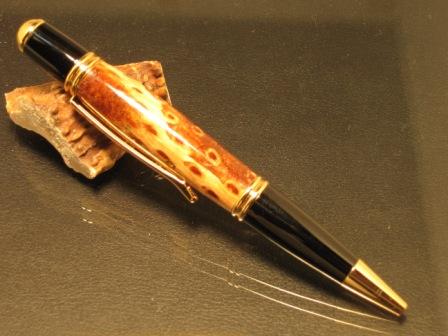

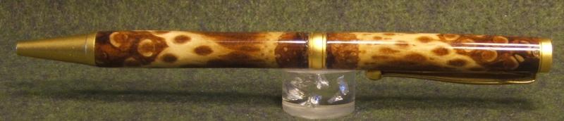

I have turned a few of them just using CA to stabilize them, Like this one on this slimline. I have used pine cones on Sierras and Guardians and most of them has been cones that have not opened up yet. I am building a Nouvean Sceptre in pine cone. I know there is not enough wood in the center so I chose the two biggest ones that I could find that were open and cast them in white pearl Alumilite using a pot.
Dang, tell me that ain't beautiful. It is. Good work.
