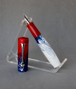

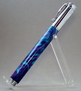

That would be one really big color/texture chart. Take one single color mixed into a clear base resin. Depending on how much you use, how you mix it into the clear resin, how you pour the blank and how you treat the tube / blank interior (assuming some transparency and talking pens), you can create dozens of different blanks.
Add a second color to the equation and you have hundreds of possibilities. Three colors? Thousands (maybe tens of thousands) of possibilities.
I feel that once you start using multiple "colors" in any given blank, how you mix / pour is just as important as what colors you are using. Give ten casters the same two colors and you'll likely get a lot of very different looking pens.
As much as someone just starting out with casting might think having a recipe book would be a great idea, I can't imagine anyone, with the ability, thinking that creating that recipe book would be a fun (or good) idea. Unless someone decided to try and make a buck by selling their recipe book.
For me, most of the fun in casting is experimenting and trying different things. I suspect that those who don't like experimenting and who are just looking for a way to end up with really nice blanks at the lowest cost, would find that buying really nice blanks will probably cost a lot less and be more satisfying than trying to roll your own.
