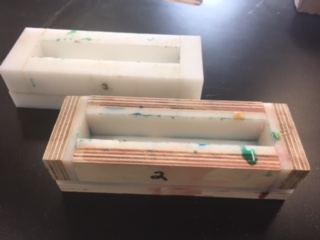

I've been using HDPE from the start and I like it a lot. I've done it 2 ways (see photo). The original was the 1/4" laminated to some baltic birch because that's what I had laying around. It worked well but I got a sheet of 3/4" HDPE on Amazon and making the mold was a LOT easier. I prefer the full 3/4" but both seem to work fine. Everything is just screwed together with #6 wood screws. Easy assy/disassy.

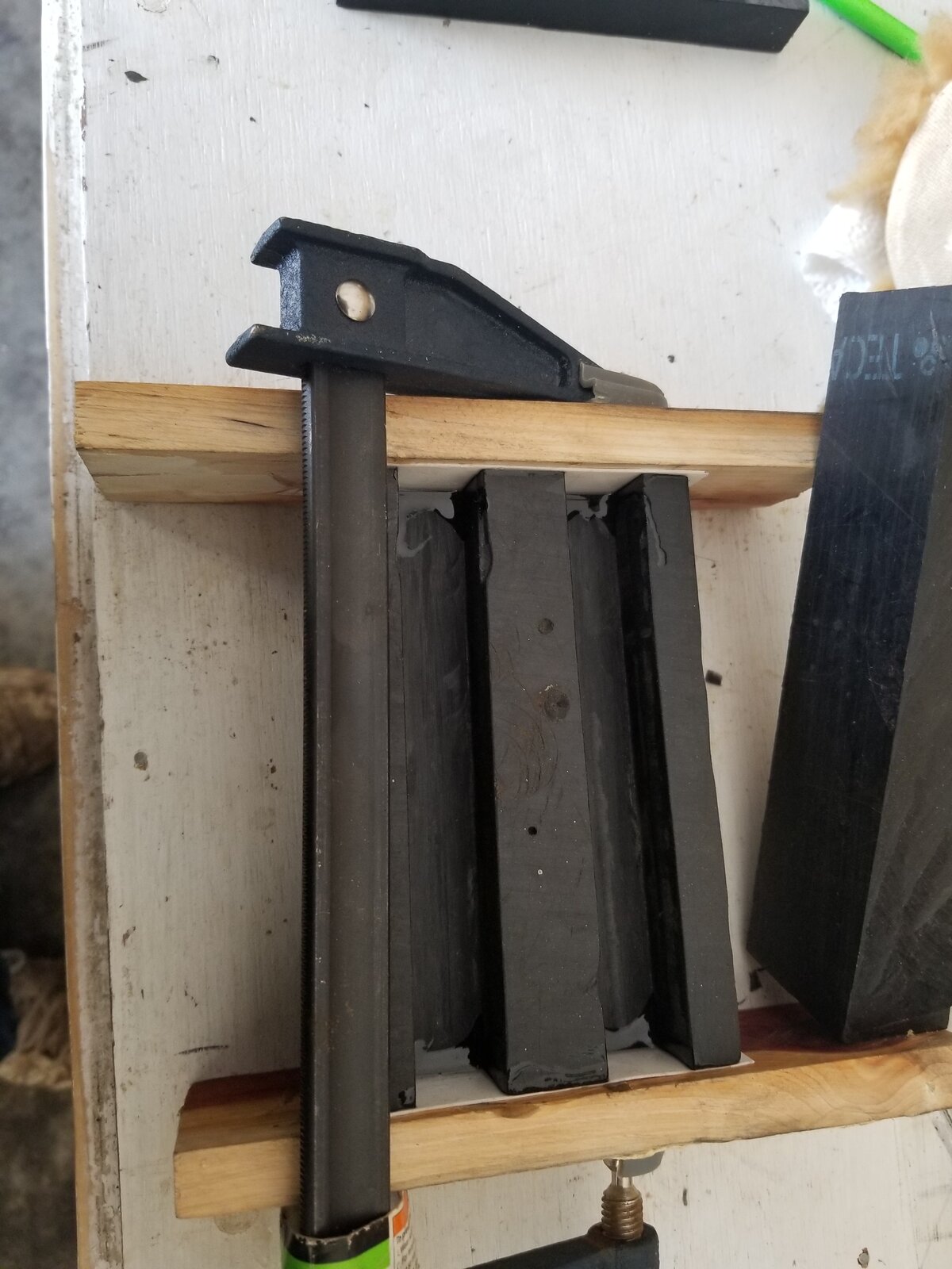

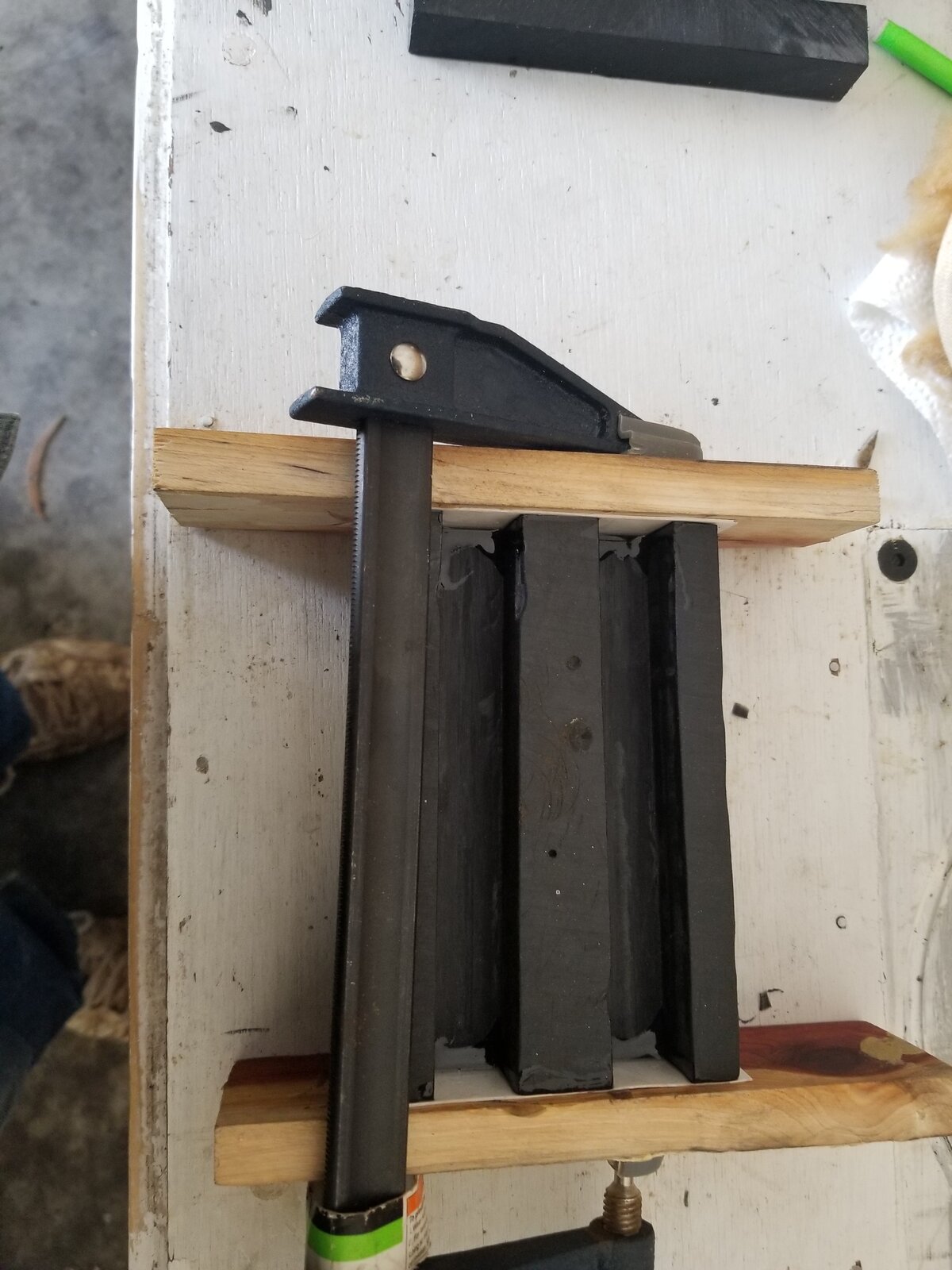

The clamp is on there for the silicone seal that I had curing. It will be put together with screws when I get the ends fixed with the tube stops. It will be made out of HDPE. I may have over killed it(dont know).
