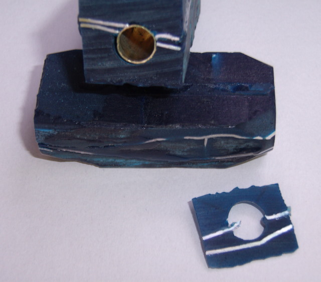

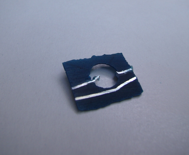

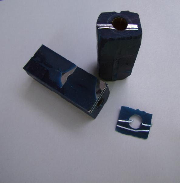

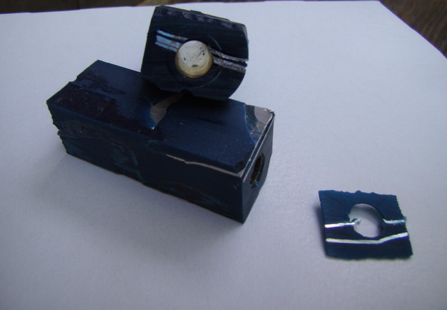

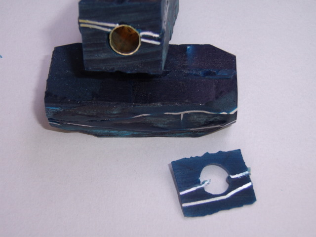

OK, JT since you asked so nicely, :) here's a PR and aluminium casting that I'm working on.
I am guessing I am looking on a pen blank. What kind of resin are you using??? It does look like it adhered to the aluminum with no problems, is that correct??? Thanks for the photos.

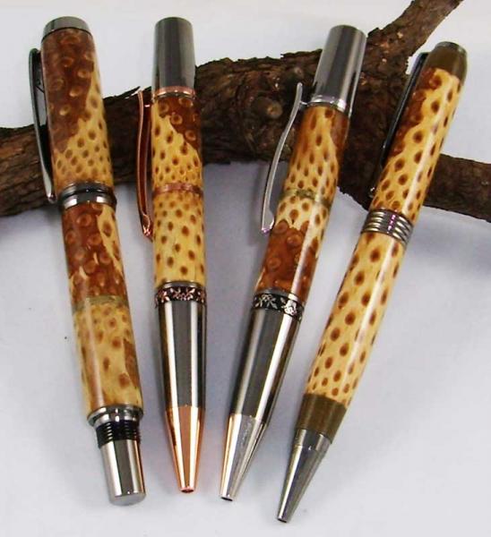

I tried casting some brass powder in resin, but when I turned it, it turned out like brass speckled green resin - ie the brass exposed was like brass, but the powder left under the surface stayed the colour of the powder :mad:. See the top and bottom filler pieces on the pen on the right. I used the same powder but with thin CA (fill with powder then drizzle on CA) to form the ring in between the pines cones on the first and third pens (copper on the second) that worked Ok.
Silmar 41 = PR The aluminum bonded to the PR fairly well, but I would suggest that you 'rough' up your metal of choice w/ sandpaper prior to casting. Make sure that your metal strip(s) is not too thick since the resistance may be too great when turning the combo (PR & metal). A little trial and error to work out the kinks. It's still a fairly new approach for me so that I really won't know what works and what does not. Live and learn I guess. Good luck with this.
