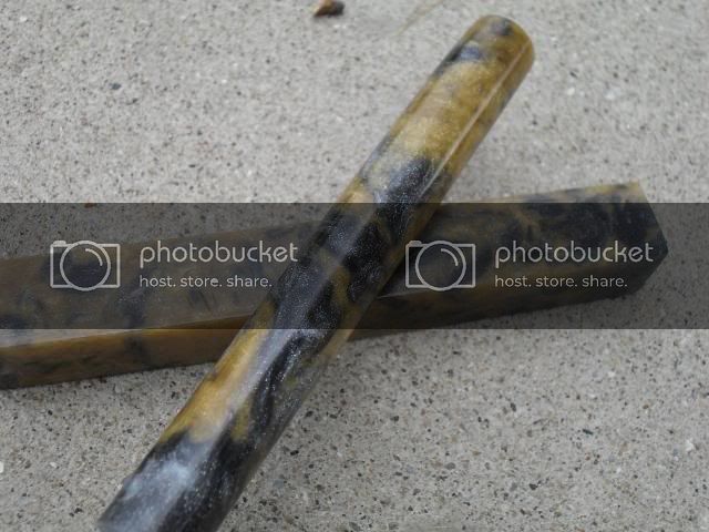

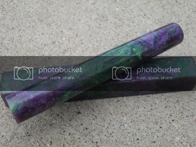

"Barney blank" purple and green

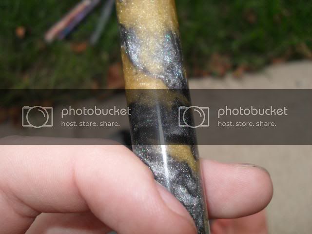

"silver and gold" gold and silvr with hologram glitter
close-up

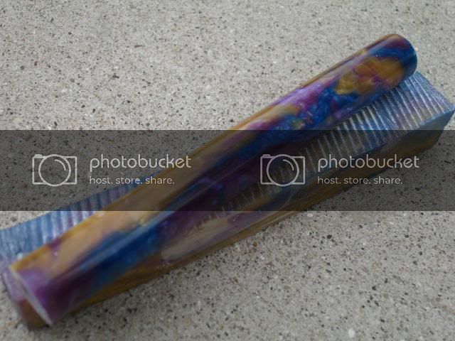

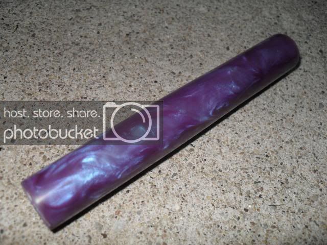

Tri-color blue purple and gold (the purple reflects blue, way cool)

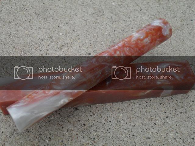

creamy sparkly white with a sort of orangish brown (really pretty)

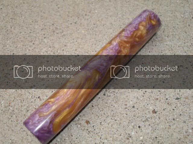

"magic" purple and gold
tell me what you think. btw i may add to this as i take pics after i turn them and i have lots more to turn. Oh and the next gallon of resin gets here saturday:eek::biggrin:

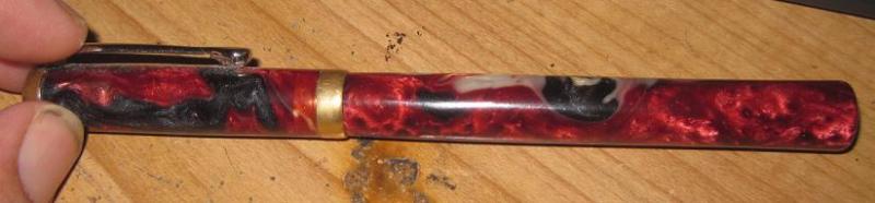

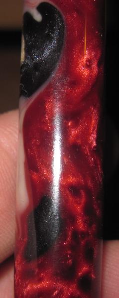

If i could find my camera, I would post a pciture of a pen that i re-did. It is a Classic American fountain.
The components look like they have been thru a war, but the blank is amazing. Originally, this pen had an orange store bought blank on it, with no paint and ugly glue lines. I turned it into a closed end with shaved center band. The blank is red, white, and black. When i find a camera i will post a picture or two! One of my finest homebrews!!

thank ya!! It isn't too bad for an old "knock around". The components have been is use for well over a year, and i have not been nice to them as you can see!
