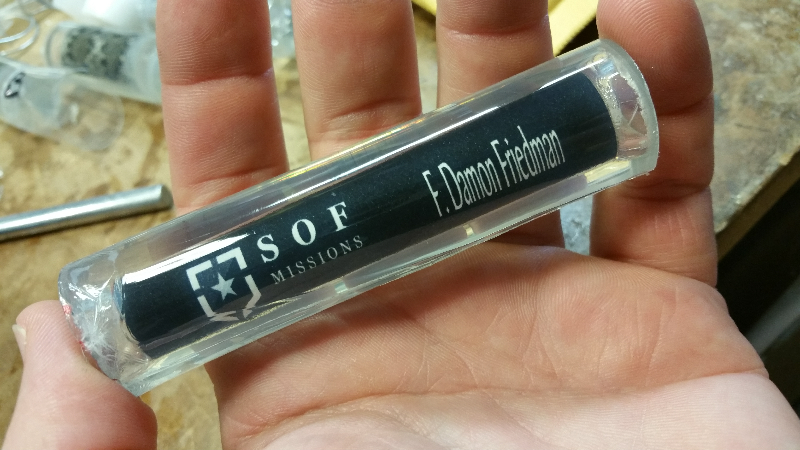

When using labels, I powder coat my tubes white and have great success with the quality and color. I also use repositionable labels and wipe a light layer of medium CA over them before casting using PR. In the picture attached, having the tube painted white really makes the logo stand out much better!
