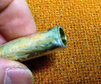

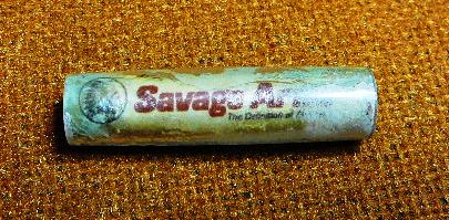

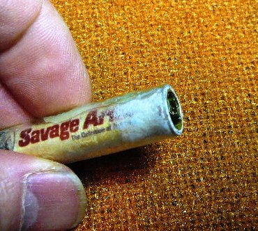

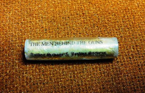

I just tried to cast a printed paper onto a tube and the results were well not so good. I scuffed up the tube, then put a little wood glue on the tube then rolled the printed paper on. I then set up my mold and poured in the Castn' Clear PR. The background was suppose to have the Savage Arms logo and the makers printed on parchment colored background. The result was the edges got washed out or whitened and the middle kind of a ripple effect.
I guess what I need to understand is how to attach printer paper to the tube and seal it.
Thanks

Don, thanks, I just found the library and think it and the comments here should help. I did not wait long enough for the wood glue to dry, it felt dry, but looks like it started leaching some. I also don't think I let the casting cure enough, since I think the white stuff on the edges is the result of sanding and I noted, although hard enough to turn and sand the tube seemed a little pliable when I took it off the mandrel. Thanks for all the help. I'll try again, after I get some fixative.
