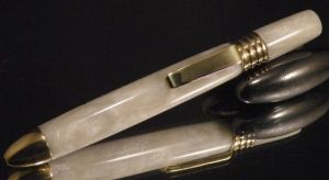

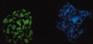

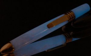

I've made a bunch of Glow in the dark pens . here's one that I posted here

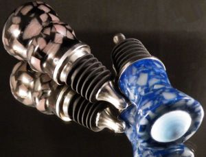

And here's a couple of stoppers
You don't need allot of glow powder to get a good glow , I only added 2 popsicle sticks worth (a small pile on the end of the stick about the size of your little fingernail) to the white pen and the moon-glo blanks used 4 sticks worth to make the 3/4" x 5" blanks that I broke up to make the chips .
