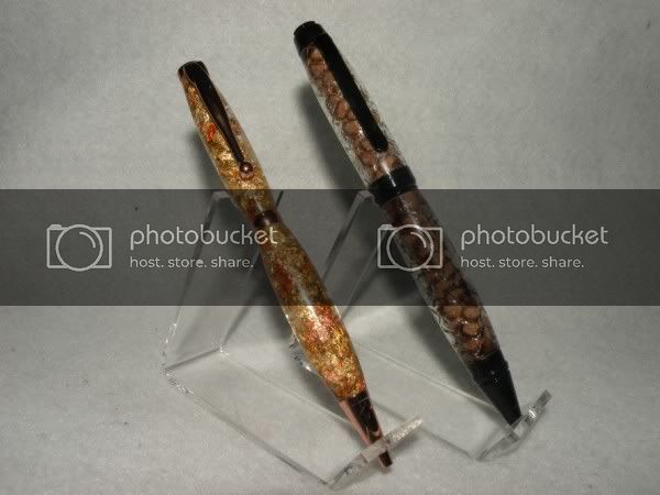

David,
What I do is spray the adhesive onto the tubes and shake them in a bag of leaf. Then I cast and still get the 3-D effect. Like this:
Chris
That's a cool effect, Chris. I'm really interested in solid blanks without tubes for finials and collars on hollow forms. Since I don't do any casting, I may have to hit somebody up to make a few blanks for me.
David:
My wife and I cast gold and silver lear all the time. I like to put it in PR mixed with Costal Scents "pearl" white. To me, the CS pearl looks better than Micro Pearl from PearlEx.
I take chef's knife and chop the gold leaf as fine as I can get it. You have to pay a little bit of attention when casting this way, as when you chop it, the leaf wants to settle to the bottom of the mold. So, I pour a little pr, wait a little bit, sprinkle in a bunch of leaf, the pour more PR.
Looks great. I just sold my last leaf pen, but I've got one of each in the que to be turned. I'll post "her way" and "my way:
