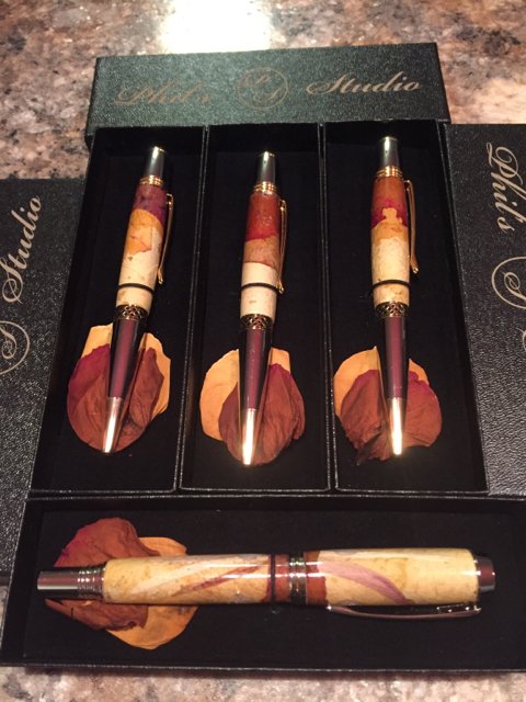

I cast 2 rose petal blanks. I let them air dry in a paper bag for a few days then cast them in PR. It took a lot of petals to make 1 blank
Cody,

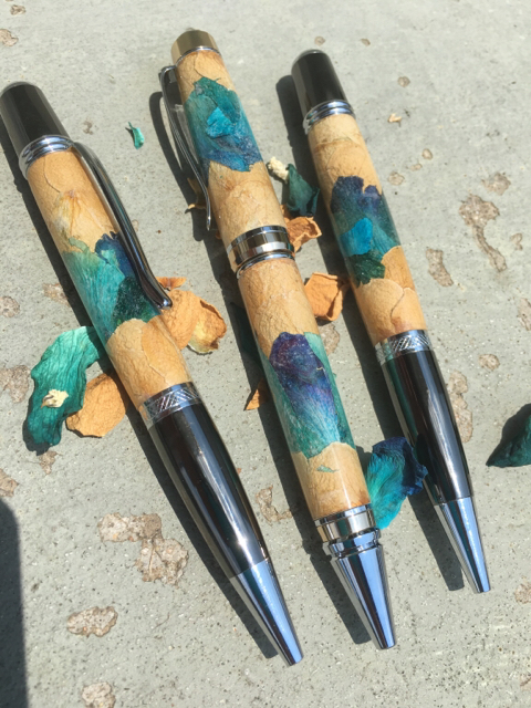

Lay them out on paper towels to dry. That's what I do. There is another way I have not attempted that dries and keeps better color. Saw it once, some kind of stuff purchased from Jobby Lobby. I them glue individual petals to a tube till the length is completely covered. Then coat with CA before casting.

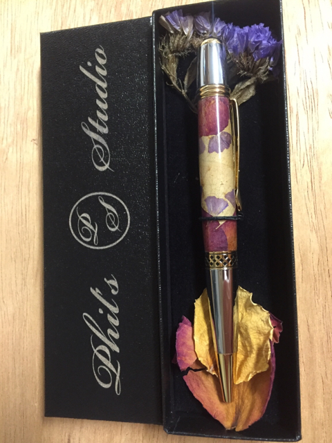

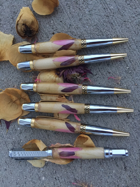

I clip flower close to stem and dry them glue on to the tube.
Firewhatfire,
Those pens look great. One question please. You say you glue them to a tube. It looks more like they are glued to a turned blank. Could you clarify?
if you want to glue them to the tube, I'd do it while they are wet and flexible with a bit of super glue - just enough to hold them in place, then let them dry glued to the tube, then cast the tube. If you want to cast them i resin, I'd let the petals dry, then in your mold pour a bit of resin, sprinkle in some dried petals, pour more resin and repeat until the mold is full.
