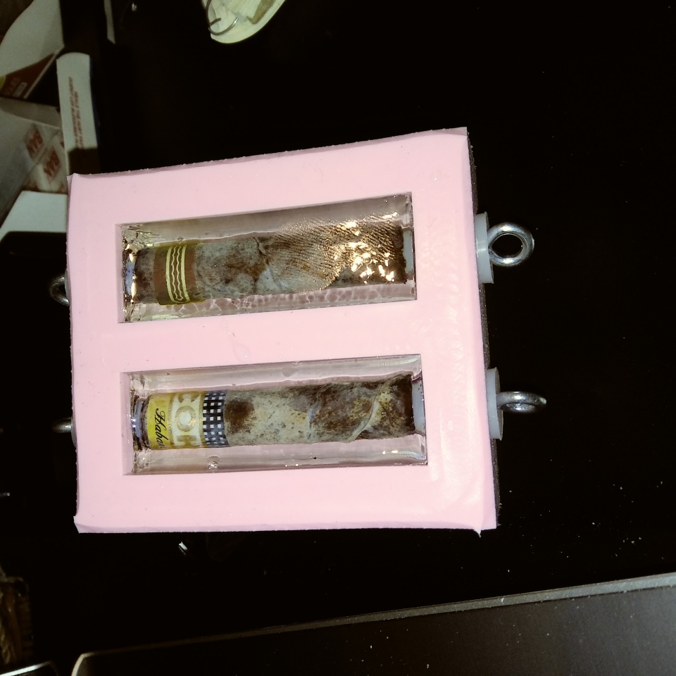

trying to cast cigar leaves.
Used CLEAR POLYESTER CASTIN RESIN AND CATALYST HARDENER FROM CASTINCRAFT
1 ONCE OF RESIN AND 5 DROPS OF HARDENNER I USE MOD PODGE TO GLUE THE CIGAR LEAFES

What would you recommend to ensure that they are fully dried out, if that is the problem?
Sent from my SAMSUNG-SM-G890A using Tapatalk
maybee after gluing the first leave on tube i should let it drye then add the other leaf and also let it drye...
they are humid.... since i have to soak the cigar in water in order to remove the leaves
People have had problems with mod podge also beside the moisture content.
Just about anything you can think of it has been tried here so I suggest doing a quick search and you may find a few helpful hints.

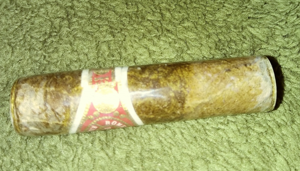

i tried one more time... all looks good till i start to turn it... White 'milk' appears at the end. Any idea why. Could it be that its heating when turning.why.jpg
Usually moisture. What are you using to adhere?? Have to allow to dry and gas off with plenty of time before casting. Especially if using CA and yes CA does gas off even though there are experts here that say it does not. :)
They were dried in the oven at a very low temp. I put 3 costs of pudge and dried every coat in the oven. why is it only the ends that turn white.
when i remove them from the mold thy are perfect. the whote appears after turning.
Then my opinion is separation. Whatever you are doing to square up the ends is putting pressure on the resin. Sanding is the only solution for the ends that I can think of.
I've bad similar things happen to the ends of my CA. I think it results when I square my ends roughly or press the finished pen together too hard. I think microfractures from strain? Just a thought.

what i did is i glued the cigar leaves onto the tube with podge. I put a bit of pudge over the cigar. I then put it in the oven at a very very very low temp for 1 hour at least. I then add more podge and repeat the drying. It come out nice. I then put in in the mold and add resin. Let it drye for a 24hours. It looks perfect. the problem is when i start to turn it.... and at the sanding stage i get some 'white' spots... I think my sanding is generating heat and the resin does not like this..... TO BE TESTED

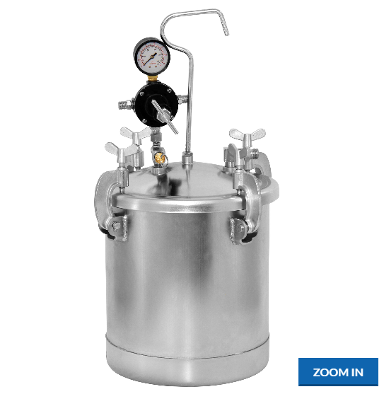

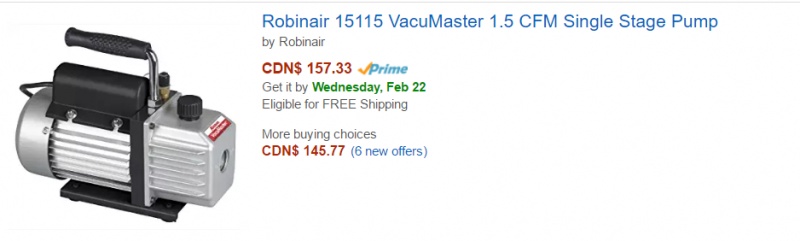

thinking of getting a pressure pot and pump. will this pump be good for a 10gallon pot.
with this pot

The pump you show is a vacuum pump. This would be used for stabilizing wood. I use a vacuum pump with a vacuum chamber for stabilizing blanks with cactus juice. Check out: https://www.turntex.com/index.php?option=com_virtuemart&Itemid=121
The vacuum pump creates a vacuum that pulls the stabilizing liquid into your blank.
The pressure pot requires a compressor for casting. When you use a pressure pot, you are creating a high pressure which essentially squeezes the air bubbles to eliminate them in your casting.
So these items you show are used for two different things.
