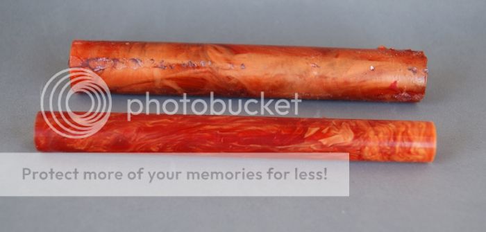

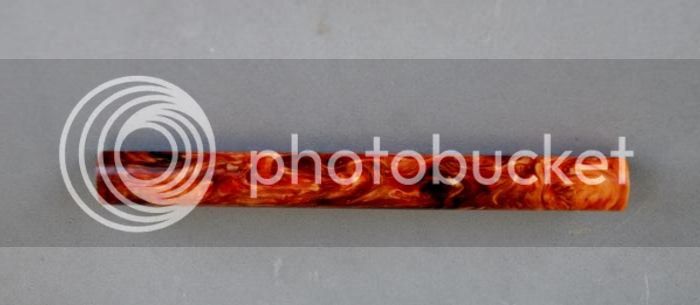

Another option would be to reverse paint the blank instead of the tube. It could really make the difference with the blanks you currently make and might not want to change! Here's an example:
Purposely translucent blank drilled out and turned down to 1mm wall thickness:
Same blank reverse painted black:
Imagine what painting with Red or Yellow or Orange might look like...
Nice blanks Jon , what do you mean by reverse painting the blank instead of the tube??
Erik
Wow, Brooks, that is stunning! I had no idea of how much difference could be made by adding a different color paint when reverse painted!
Thanks for the quickie tutorial.
