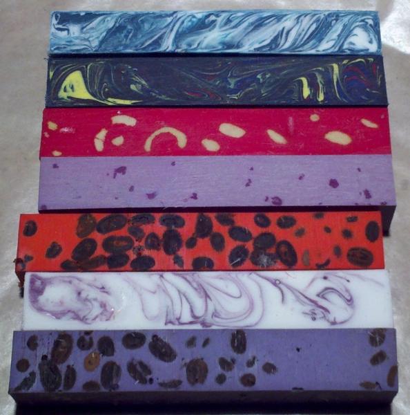

Let's see if I can post a pic of the castings I did this evening. The 5th and 7th down are coffee beans. I don't have a pressure pot as of yet but I probably will get one in the future.

I've been using Alumilite white without a pressure pot without any problems so far. I'll try to post some pics later this evening.
Casting and turning cast blanks are two different things. Have you turned the bean blanks you cast without pressure and if so, were they 100% bubble free?

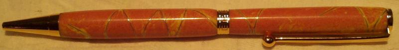

Here is one I did today. Alumilite white with aluminum embedded in it. No pressure pot used and no bubbles (guess I just get lucky). The coffee bean pens turned out ok but a pressure pot would have made them better I'm sure (I'd post pictures but they were already sold).
