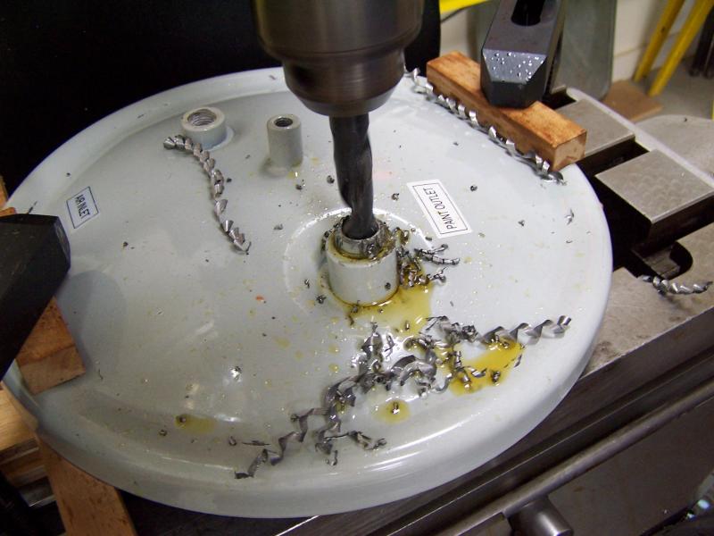

Will this work?
Paint Pressure Tank - 2-1/2 Gallon
What would I need to do to it to get it to work for casting?

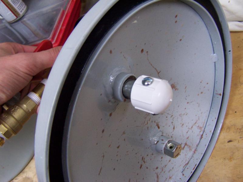

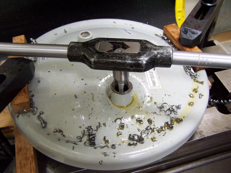

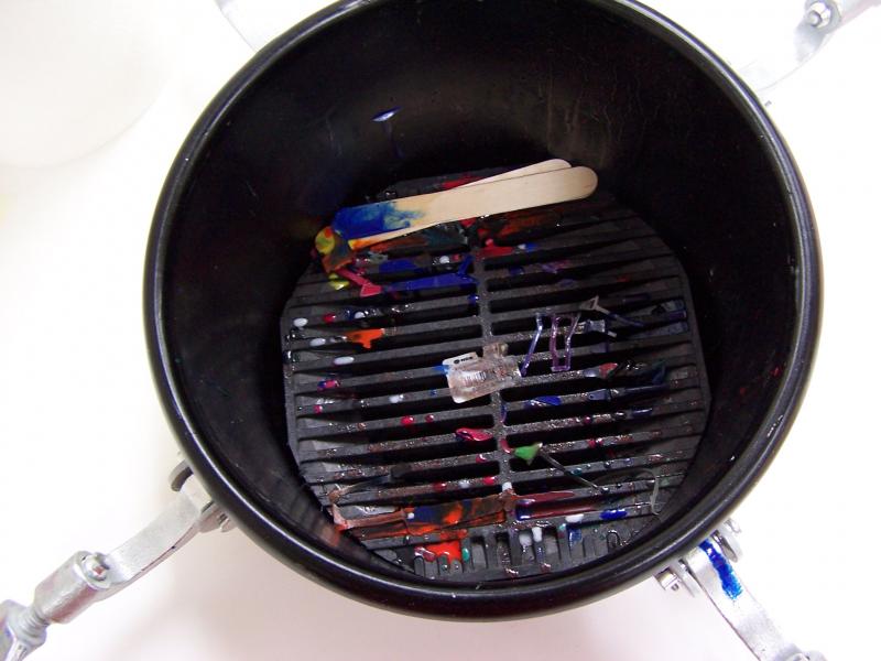

Yup, that will work. I didnt follow the tutorial down the the letter, but I got the idea, since I had never done anything with pipe threads before. I had to drill out one of the glued on peices of metal in the cap and retap the hole. But hopefully if you decide to pull the trigger you will not have this problem. In the end it will prob cost you $200 to start casting with a pressure pot. For leveling out the bottom you can take a drain cover from home depot or lowes and cut the corners off and put it in the bottom of your pot. That is what I did and it works rather well. Just if resin gets in the bottom it is hard to get and out you have to put a piece of metal in the grooves and crank on it. (2 person job)
Also in the tutorial he caps the inlet valve with a fitting. I just drilled a hole in the remaining pipe and drilled a hole in a pvc pipe end and put a screw though it. This prevents the air from shooting straight down on your resin and making a mess.
