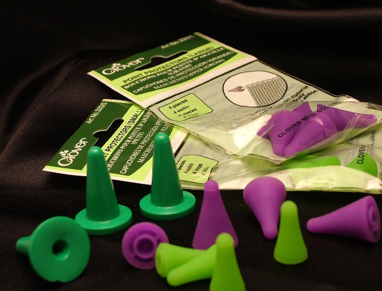

I use knitting needle point protectors from Walmart and fill the tubes with BBs.

Not all WalMarts have the same stock, I've found. Jo-anns should have them,
but the last few times I went there, they were out and hadn't replaced them
since I bought the last of them.. At Jo-Anns, they're right near the knitting
needles and crochet hooks. They've usually got the big green ones (too hard)
and the small neon green ones (too small, they get sucked into the tubes)
so go for the purple ones.

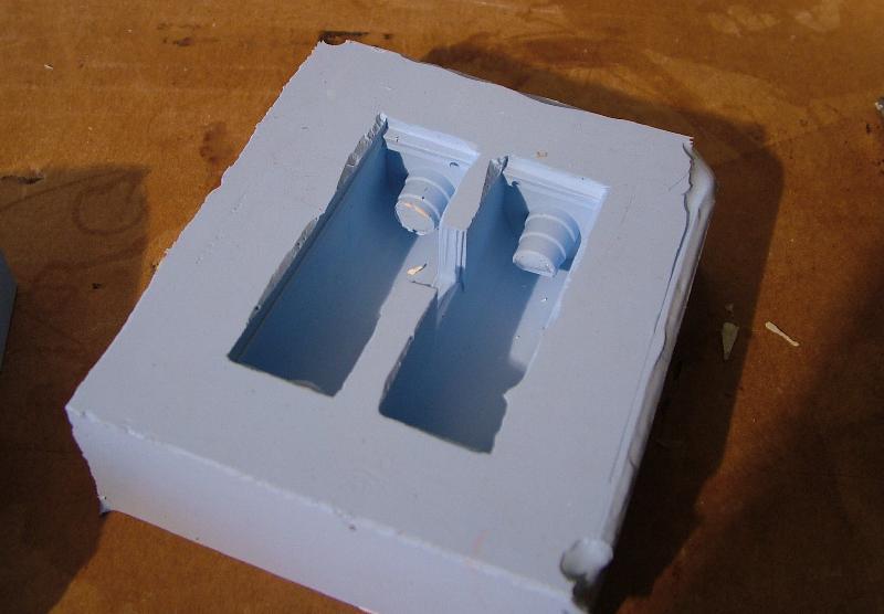

So I am guessing the reason you now use clay is because you had failures with resin getting into the tubes???? I guess I will have to try a few and see what happens.
Well, I think when you add a lot of pressure to the equation it promotes PR filled tubes.
I'm hoping this might solve that problem, as well as the problem of adding
weights to hold down the tubes, wood to hold up the tubes and larger molds
that eat resin. Three people are testing them now, but after I get their
suggestions and refine it, I hope to offer them here.
That is if they don't tell me to scrap the idea..:eek:
Charlie, you just might have hit on a great Idea, if you could use the mold for 2-3 different kits. I noticed that the stoppers in your mold are stepped, what different kits will these work for?
They're stepped only because that's a prototype straight out of the mold and
I didn't trim the stopper. I used a step bit to drill, but that doesn't
make it usable for other kits. The length of the mold is sized to
accommodate the individual kit. Some kits use the same tubes. But a Sierra
mold (for instance) won't work for a Sierra Click (and vice versa) as the
tubes are different sizes.
The final mold won't have as much of a stopper in it, as it isn't necessary.
The mold size and the diameter of the stopper both work in conjunction to
keep the resin out of the mold. The length isn't needed, and in fact it may
make it difficult to get the tube in and out. And those tubes can be sharp
on silicone..
I'm working on several kits right now. With the exception of the Slims and
similar, I'll be able to do molds for all the kits currently available within a
couple of weeks. (after testing, feedback, revision etc.)
One of the people testing it suggested larger molds with multiple kits in it.
The one pictured is two Sierras, but a final mold could easily be 6 or 8 as
long as it will fit in the pressure pot :tongue:

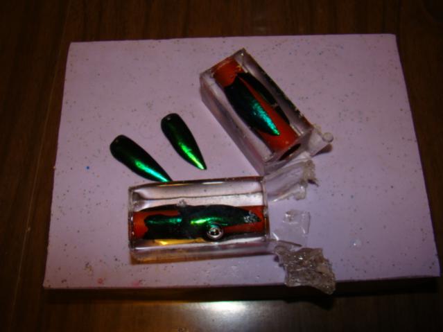

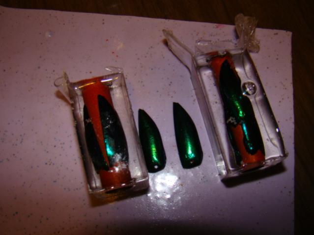

when i cast my beetle wings, I used a potato.
I just pushed the tube in to make the plugs, kept going untill it was full
I did not have any moisture leaks.
I did not use the Pressure Pot on this one
I used alumilite

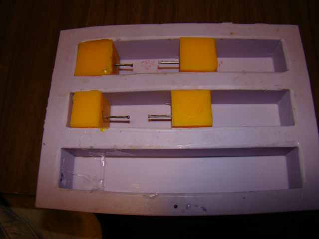

What are the yellow blocks made out of?
I've previously just used old wood cutoffs, but recently I found out that some kinds of wood inhibit my PR from hardening.
