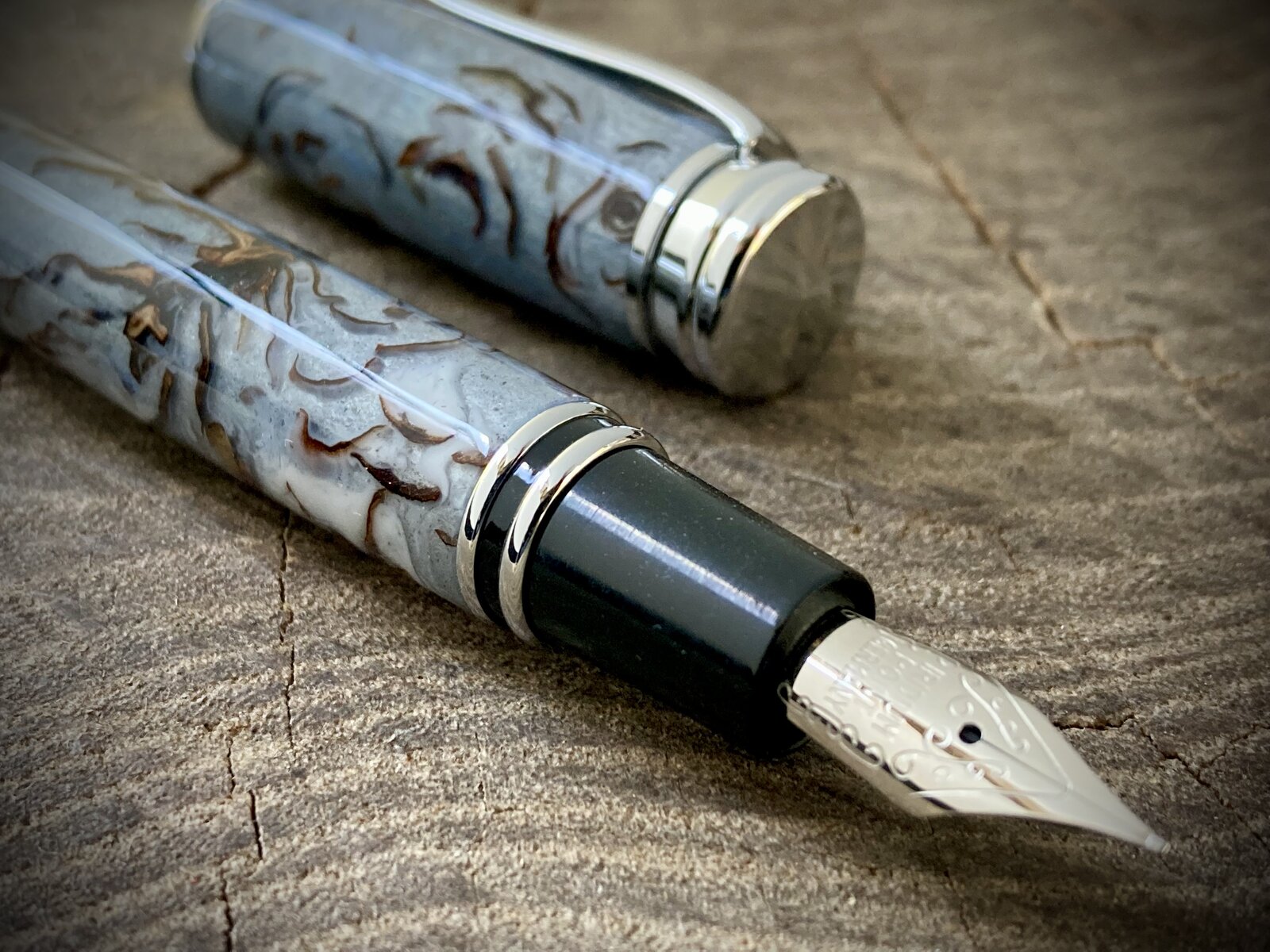

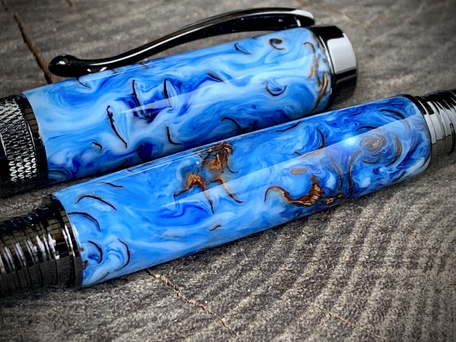

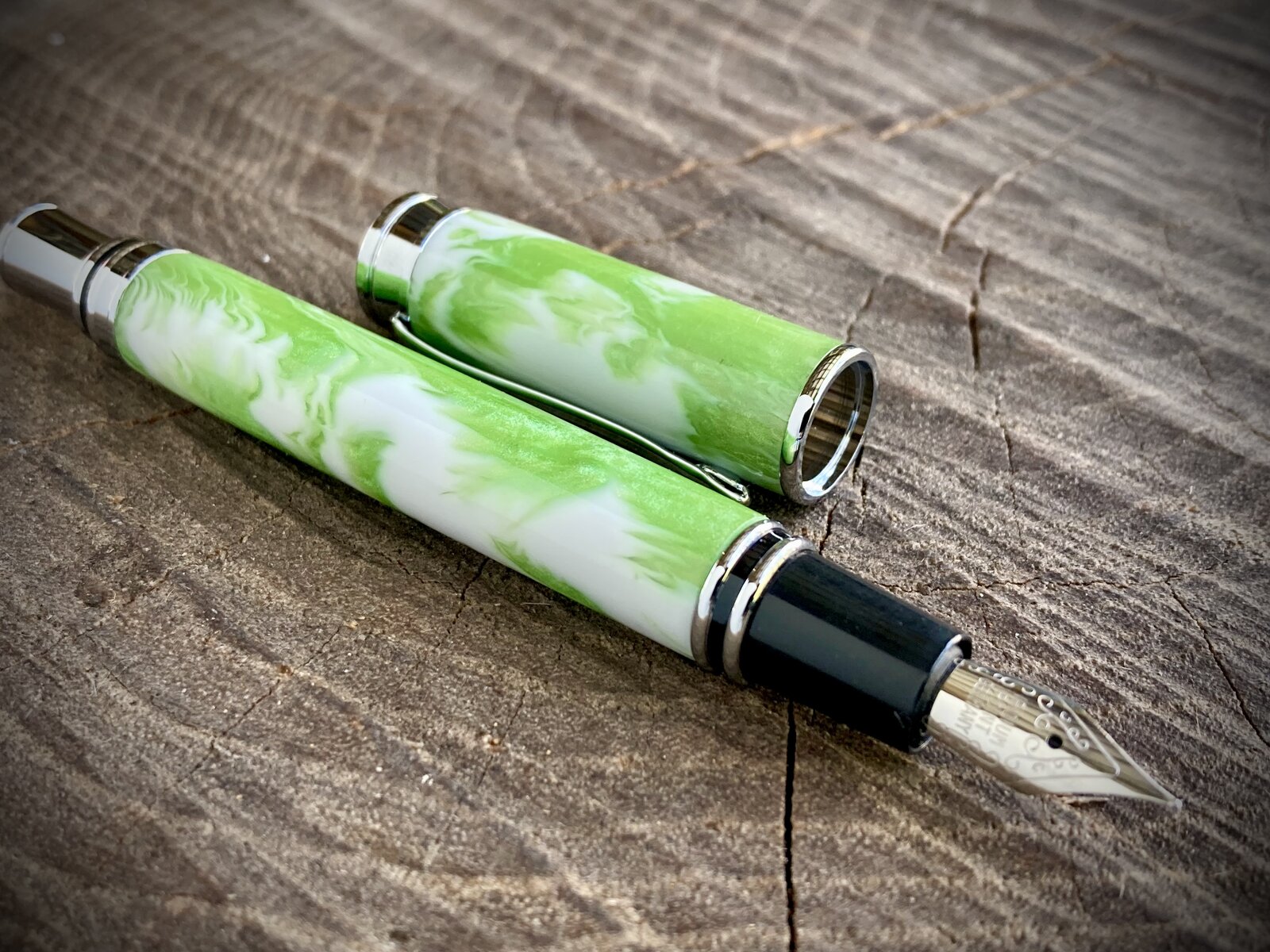

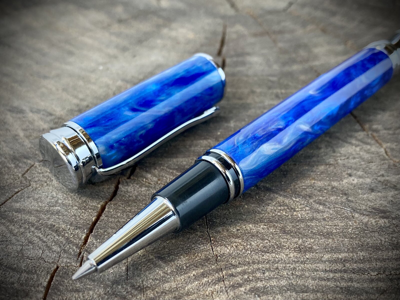

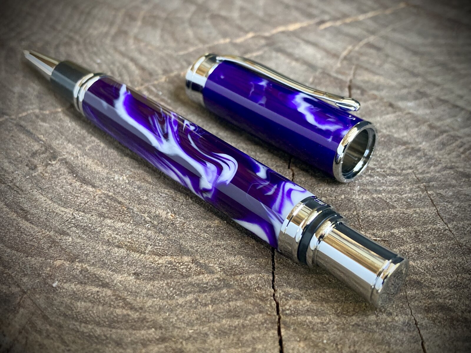

Here are some self made blanks that I'm proud of from last weekend.

View attachment 378661View attachment 378662View attachment 378663View attachment 378664View attachment 378665
