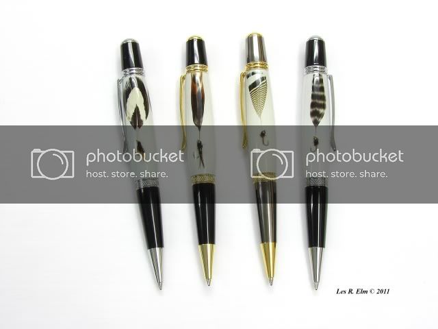

Why not try some Flies and Feathers?

yeah, that is a fall back if the worm thing fails - I am going to tear apart a few different ones and put a few in some resin for S&G's...might be fun
He's not a fly fisherman...mainly bass/stripers etc so the feather/fly aspect is not in line with his type of fishing.
