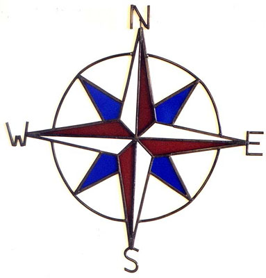

I don't actually know what a compass rose is.
A "compass rose" is the marking on a chart (a nautical or aeronautical map) that shows its magnetic orientation. On modern charts, it includes graduated marks for all 360 degrees. More traditionally, it looks something like this:
I've wanted to do a segmentation of a compass rose for quite a while, but haven't gotten around to it yet.

Maybe I should rephrase this. Since I can't find a bulk buy on some Compass rose trinkets,
I was thinking of printing out on paper the desired compass and basically cast that in the stopper instead.
Since some turners here are doing this on pens, I was thinking of doing it for the stoppers. So do you think this would be tacky to do on a bottle stopper (on top)?
I have no problem with the casting part of it. Actually one of the pictures I had saved of a compass rose the other day is exactly like the one shown above by Sylvanite, there are a couple of other designs. But thinking that paper compass rose casted may work and more affordable than buying up trinkets.

I know what I would do. I would copy this as a jpeg file. put it into a "paint" program, get it sized right and print it onto decal paper. Then I would transfer the decal onto the end of a round acrylic or PR pen blank that complimented the bottle stopper material, cut the piece as thick as I wanted to embed it into the stopper, drill the top of the stopper, glue in the compass and then CA finish it.
Treat it the same as you would a "do dad" that many turners put on the tops of stoppers. If you wanted to give it 3D look, you could put the decal over a pretty "shooter" marble, quartz, etc.
Total cost (including the marble :) ) about $1.
