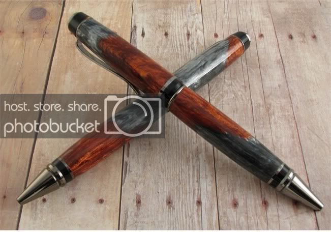

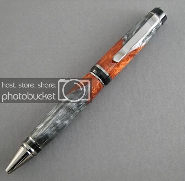

What I have done is exactly as you describe. I measure the mold with water then pour that into a cup and mark a line. I would seperate then based on what I was trying to do. Mix the powders or whatever your colorant is well then start adding the hardener. After a few minutes (you will learn when it is time based on the amount you add) you can pour the resin together in the mold and mix or swirl how you see fit. These are a few of the ones I came up with using the basic Pearl-Ex set. I tried other pigments but never had them mix quite as well. I would mix them and then I would pour into the mold at the same time, trying to get them to swirl together while pouring so I wouldn't end up with one color stuck on each side. On a few of the ones I cast, I stuck a toothpick and slightly mixed or swirled. For the mold, Wal-Mart sells or used to see some ice cube trays that make long circular cubes. They have removable bottoms and work perfect for half a pen. I know lots of people here use them or at least used to use them.

Thank you for your info!! I had already got the ice cube molds that you spoke of. I will give it a try tonight. Again, thank you for sharing!! Your photos and casting are excellent as well
