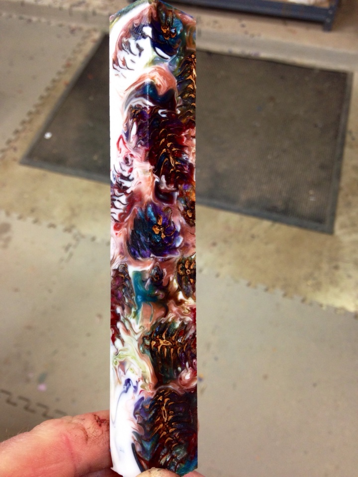

Caraazy pinecones
wayneryan65
Jan 7, 2013
104
Euless, Texas
I love how the white seperated all the colors. I used a 6 color pour on this one with 80psi in the pot. I think this ones a winner
Looks great Wayne. Should turn beautifully. What type of pine cones do you use, and how do you make sure that they're dry enough for casting? Thanks in advance.
Dave
Don't know what type they are but what I learned from Curtis Seebeck about drying wood helps a lot. I put them in the toaster oven at 200 for 24 hours then place them in a bag so they cant draw in any moisture as they dry
