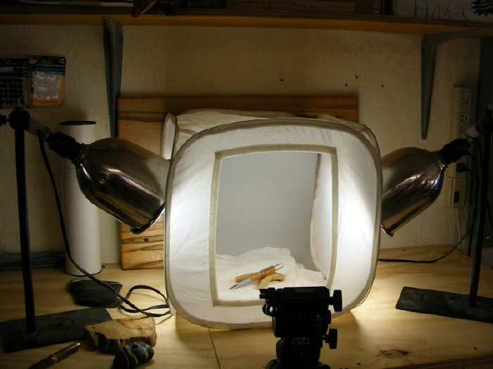

This is the photo tent that I have made from a sheet and some scraps!! The worklights are just what I had laying around...Its a work in progress. I have a nail sticking through the paper to stand the pen up...I am going to lay them down and try it out. I already have a tripod to use I just have to get the little things right.
I will post a pen here in a bit...I will fool with the settings and try it out.
Thanks Again,
Grub32
If you have any suggestions about the light tent, let me know!!
Ok, that looks pretty good. Are the sheets truly white? They look a little beige to me. And I would make the background a different color.

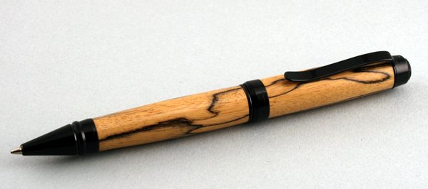

They are cheap dollar general white sheets...here is a photo that I took with your settings. When I adjusted the color using a photo editing program, the background went from gray to white!!
