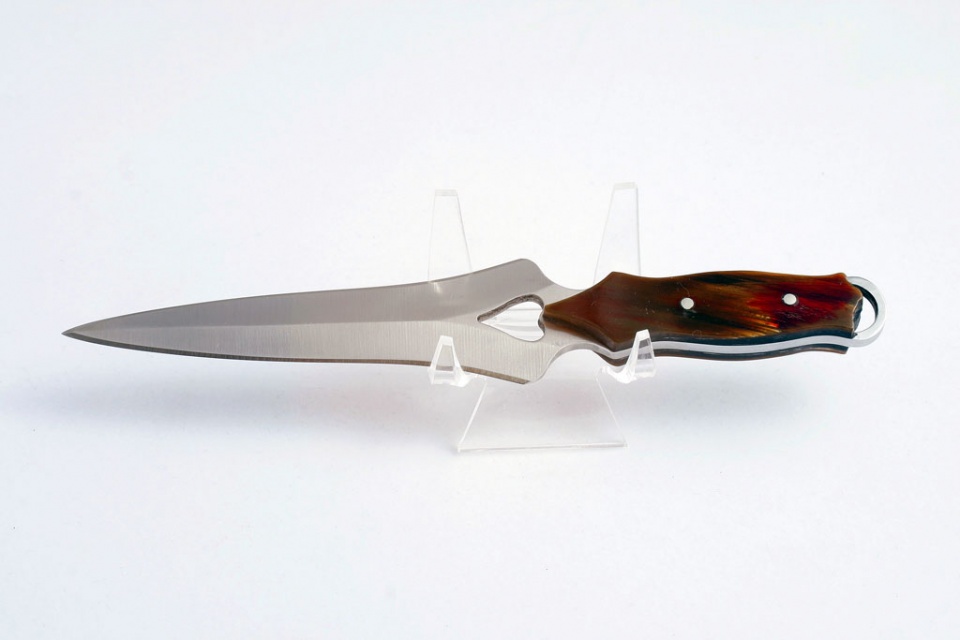

This is some red dyed buffalo horn that I did 7 years ago. The thickness is at most 1/64" and on the edges it is very visible where the dye reaches.
