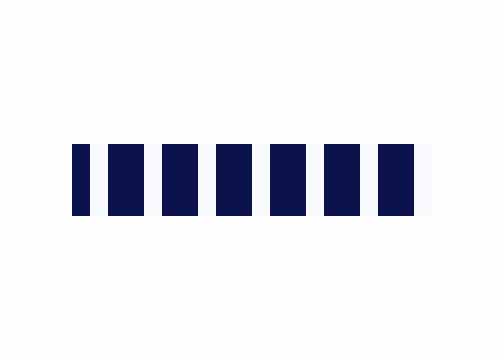

I Ian57 Member Joined Oct 2, 2012 Messages 10 Location Cocoa, Fl. Oct 12, 2012 #1 Hi Can a blank be made with blue and white stripes similar to my sorry attempt in photoshop? Attachments Blank.jpg 18.1 KB · Views: 146
D dexter0606 Member Joined Jun 11, 2009 Messages 525 Location Cambridge, ON Oct 12, 2012 #2 Just segment it
mredburn IAP Activities Manager Staff member Joined Jul 5, 2009 Messages 8,776 Location Fort Myers FL Oct 12, 2012 #3 The easiest way is as Jeff says is to segment it. The harder way would be to cut one of the blanks into pieces. Drill and glue them on the tubes. Then recast them in the second color. The only advantage would be no glue lines.

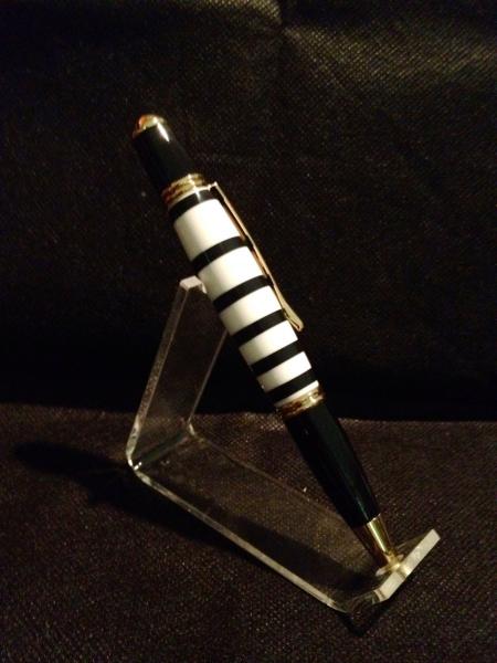

ronfinch Member Joined Dec 8, 2011 Messages 59 Location Bush, Louisiana Oct 12, 2012 #7 Like this? This is Alumilite... Attachments image.jpg 33.3 KB · Views: 140
