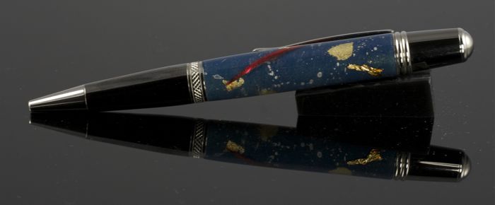

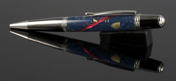

There is another way...
I made a pen where I painted the tube dark blue with a couple of little silver "spritzes" on it. Then I put on a layer of thick CA and added some gold leaf. Then 3 layers of thick CA. Wrapped that with a red reflective ribbon. 4 more layers of thick CA. More gold leaf. More thick CA.
By the time I was done I had a full Sierra pen blank out of nothing but CA and "floating objects".
Things I learned: don't rub the gold leaf - it becomes gold smear; don't sand the CA between coats - you seal in the sanding scratches; wear a filtered mask - that much CA fumes will kick your sinuses behinds and they may never recover (I really miss the smell of turning but now I HAVE to wear filtered masks when I do anything or I'm toast).
