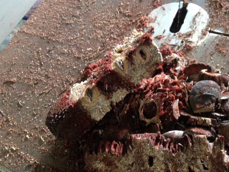

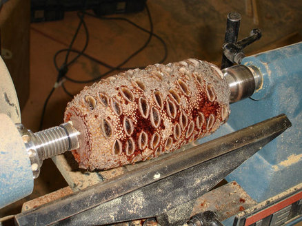

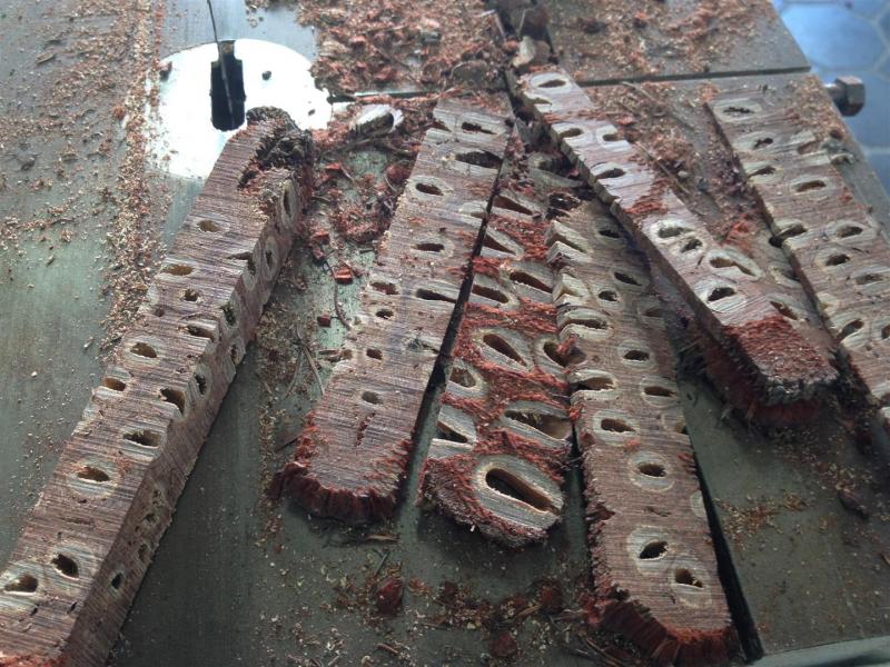

Hi guys,
Can you please put on your thinking caps and give me some advice? I have been sawing Banksia Pods for some pens I've been asked to make and it seems a shame to throw out the bits left over. I have broken seed shells (half round bit bigger than your thumb nail), slices of varying thicknesses and the brown dust and red dust. (See pics).
What would you do with them and a bit of Polyester Resin??
All thoughts appreciated from you guys and gals!
Jus

I recently pretreated a Banksia pod with thin CA. I have turned the ends and cut the main body to pen blanks. I have seen no red fuzz and the outer skin is intact with very little tear out. The bits left over are in purple and blue PR. At 3/4 inches thick how long might it take to set up? This is my first attempt at mutt blanks...
I think I would start by placing the nut scraps on a piece of waxed paper, then carefully fill each void with a different colored stone and glue. Once dried, I'd run it over the belt sander to flatten everything, THEN, I'd cast them in clear resin and use them as interesting and unusual segments in pens.
IN FACT, if you have LOTS of scraps, I WOULD LIKE to try this!!!!
No one can answer this question for you as there are two many variables, such as temperature, moisture, amount of catalyst, etc. Generally, when I cast in resin, I'll just leave it under pressure overnight (or all day). It's probably overkill, but leaving it longer will do no harm.
