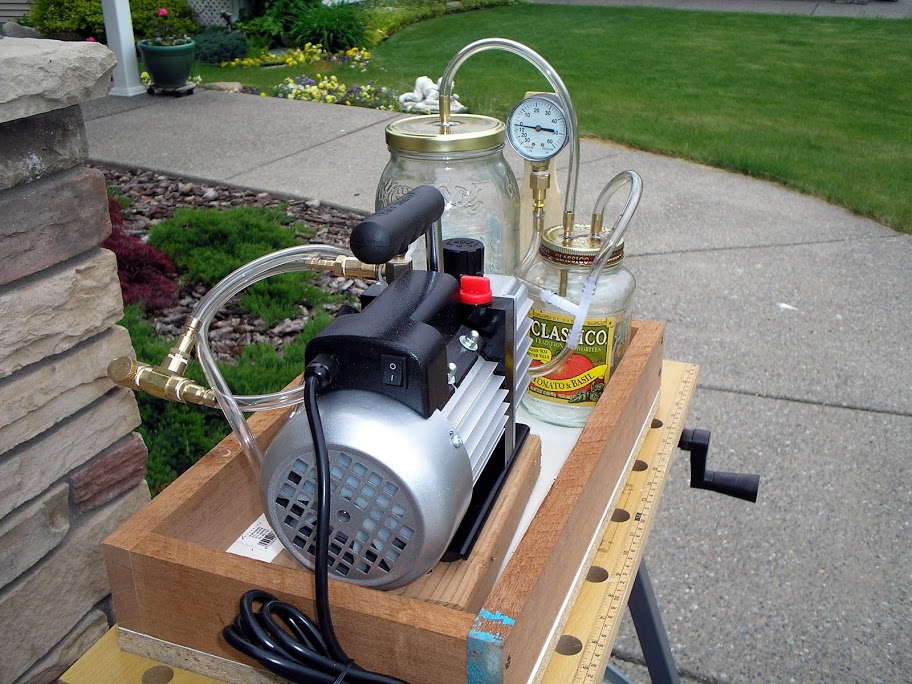

I've been busy but found some time to make a new vacuum system.
Using a Pickle Jar but with an added features like a "Catch Jar" and a real vacuum pump instead of the Venturi I was using.

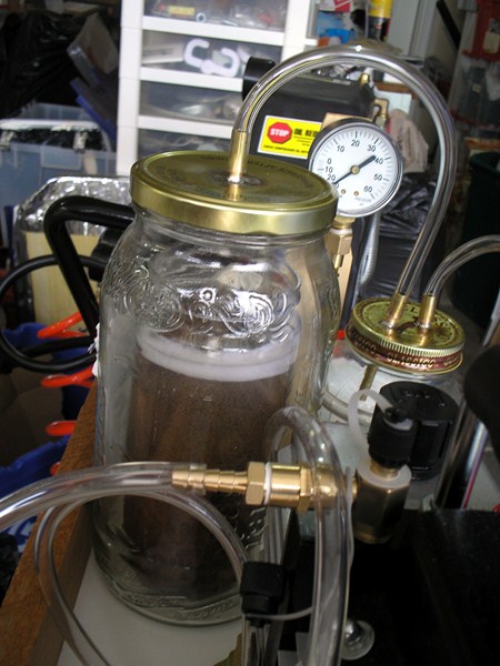

Here it is pulling -28 hg and has been foaming for about 15 minutes with some really punky X-Cut Amboyna in Cactus Juice.

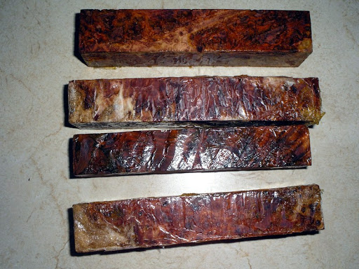

Right after this pic the brand new pump decides to croak. I let the blanks soak for about 2 hours while I go and get the pump replaced.
Tried to pull a vacuum with the second pump but no bubbles so I pulled the blanks and had an interesting experience with two different toaster ovens not being remotely close to temps on the dial and checking with a digital thermometer.
This is the result ...

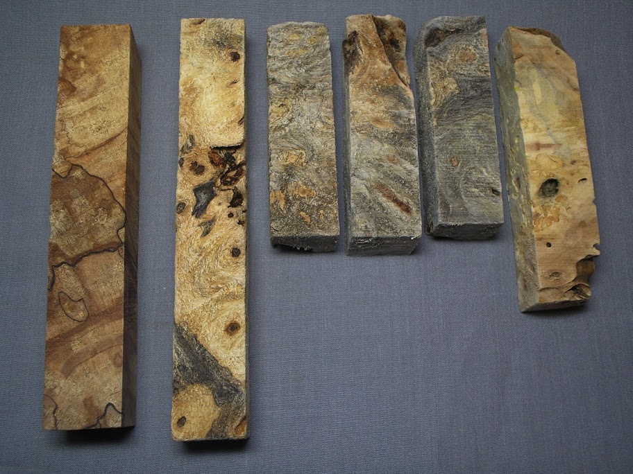

Decided to try the new pump out and placed a piece of Spalted Apple, 3 pieces of dark Buckeye Burl and 2 pieces of what is labeled as 'Golden Buckeye Burl' into the jar and used my usual mix of 50-50 White Glue and water.
This is after pulling vacuum for about 45 minutes and then drying under a rather large forced air furnace for a few hours at work.

Well I know the penetration was total on the Amboyna because I cut a sliver off.
On the Punky BEB and Apple the blanks come out looking like a big stick of White Glue after sitting in the jar for an hour. And when sitting under the forced air heater dried clear.
I turned one BEB and I used just a little CA as I turned and I'm not 100% sure I needed to use it but did so simply as a precaution out of habit on the spalted areas.
The X-Cut Russian Olive on the other hand is different. Some of the pieces fell apart at some spalting lines and I CA'd them back together but haven't tried turning any yet.
