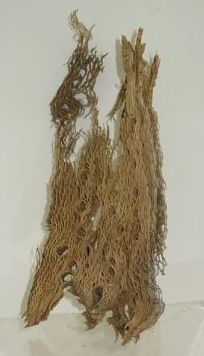

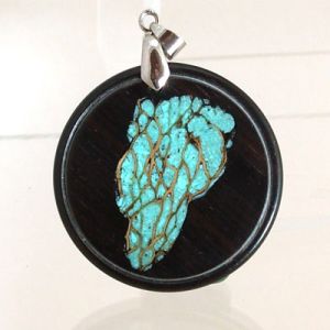

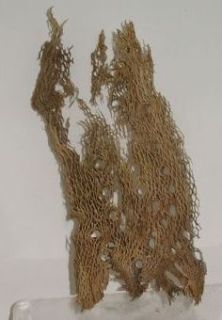

Cactus skeletons, dried naturally, look like those shown below. The picture on the left is rotated slightly so that you can see that the piece is actually three layers. The actual size of this piece of pad is 6" x 2.5-3", with the layers ~1/16" thick. These are fairly brittle, but are easily separated, and then can be cut with sharp scissors or X-acto knives. The third picture shows a piece of skeleton inlaid into a Kingwood pendant and filled with Turquoise.
If anyone is interested in these, I would be willing to trade. I'm not a pen turner, so I don't need any pen blanks; I CAN use pen blank cutoffs - especially figured acrylics, tagua nuts, palm nuts, small burls, burl cutoffs, small exotic slabs, etc., suitable for turning miniatures and other small pieces. I would send a small flat rate box full of skeletons in return for a small flat rate box containing material I can use.
