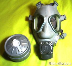

When I use CA my eyes, nose and mouth go into revolt.
I had to do something, and sometimes people laugh, but I use this when I am doing CA. It blocks everthing and protects my eyes, nose and mouth. It's only @ $13.00 and mine has lasted a year so far.
