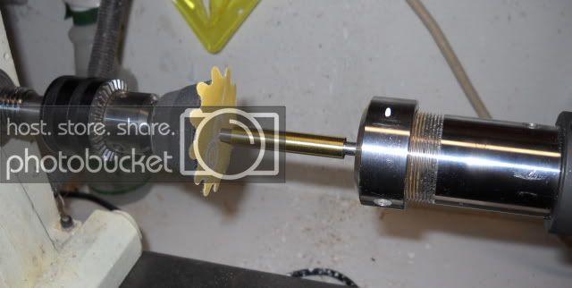

Newbie here, but I've done about 10 CA finishes so far. I haven't yet tried the BLO step, but I will. Instead, I've used a spray accelerator.
My question, when removing the bushings from the completed blank (with the CA finish applied) it is necessary to "break" the bushings off of the blanks. At times this has chipped the finish and leaves a visible defect on the pen.
Is there a way to avoid that? Am I doing something else wrong as well?
