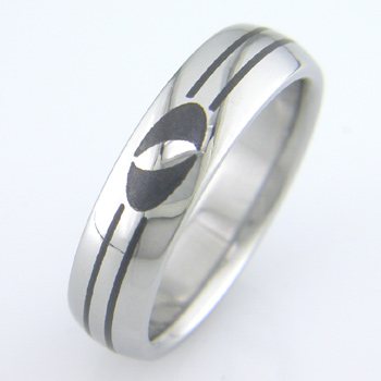

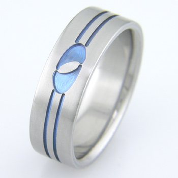

Here's what they look like. These have the college logo either in laser ceramic like this one or carved in and anodized.
<br />
<br />
Randy, most are engraved on the inside. They were able to choose what to engrave and what font to use. I can't cost effectively do sculpted rings like you normally think of a class ring because these are all machined. I am toying with the idea of getting another machine with a 50,000 rpm spindle that would make carved rings more cost effective though.

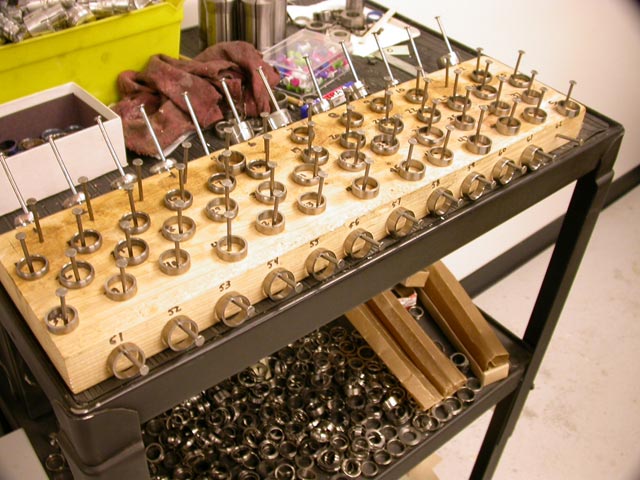

After a couple more orders, I finally finished cutting at midnight. Here's what they looked like about an hour before that.
<br />
Randy, the second shelf is rings that either cut to a size that was out of spec or something moved or slipped during machining. A lot of them could be remachined if necessary, but it's usually easier just to start over. I find that the number system I have here works pretty well. I use my machining center's steel enclosure walls as a place to hold my paper order pages with magnets so I can see at a glance what I have to work on. It helps make order out of the chaos.
