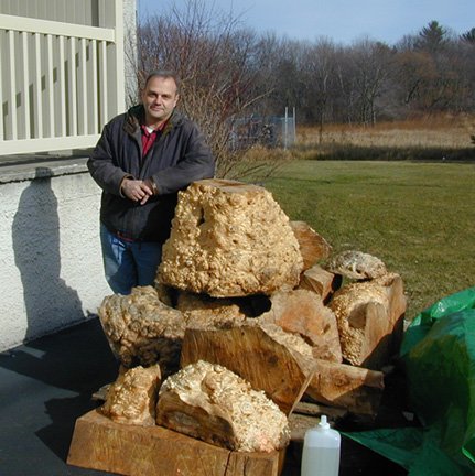

I turned tons of burl and I never had to stabalize any of it, so far not a single piece has fallen apart.
- If there are voids, I fill them with coffee gounds and thin CA.
- If the burl is punky, that is a different story.
What condition is burl in?

Originally posted by Ron in Drums PA
<br />I turned tons of burl and I never had to stabalize any of it, so far not a single piece has fallen apart.

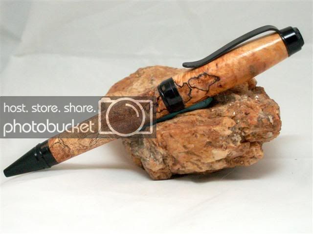

Iam unstable and so was this befor I turned it !! LOL I stablised it with thin CA after turning with sharp tools and a LOT a care !!! By the way it sold in less than a Hr on our web site :O)
