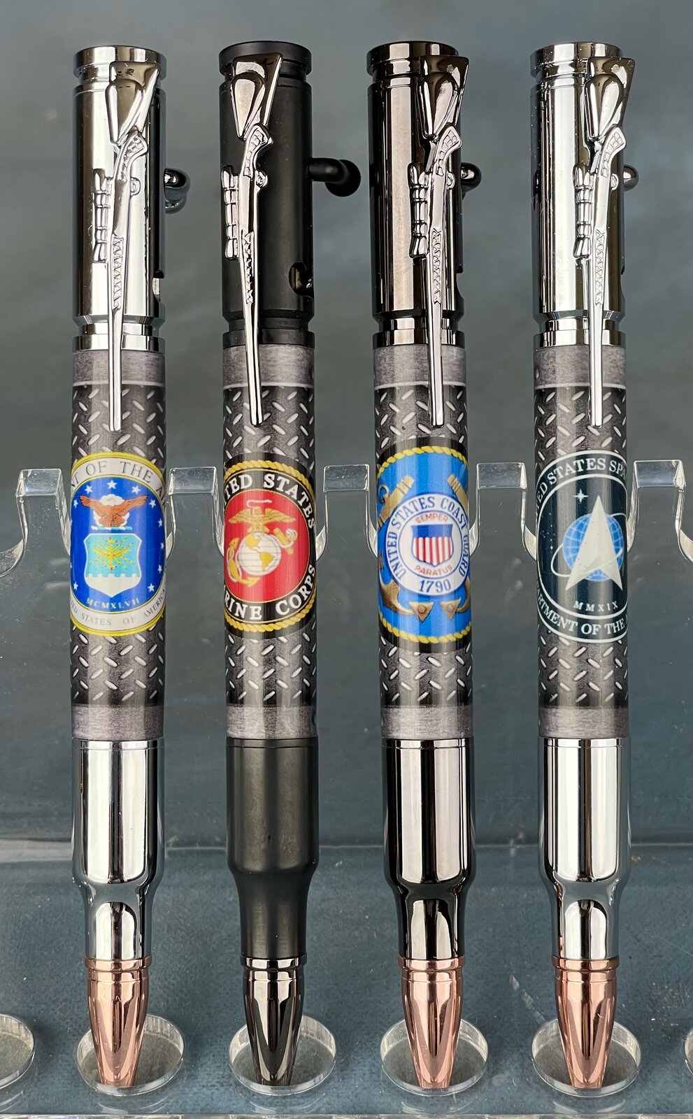

Here are some pens made with alumilite that took about 30-60 seconds from sanded to done in the lathe. I never use wax as it constantly dulls and must be rubbed to look shiny again. Without wax it is shiny all the time. I've tried both!
