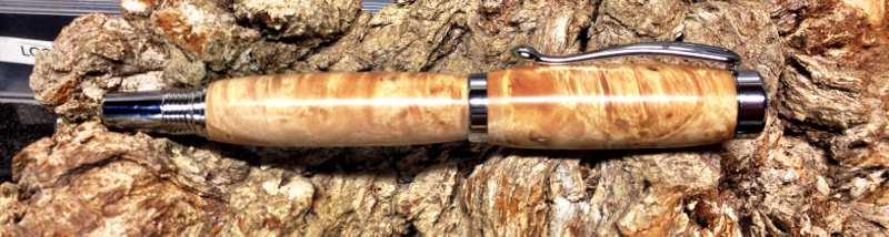

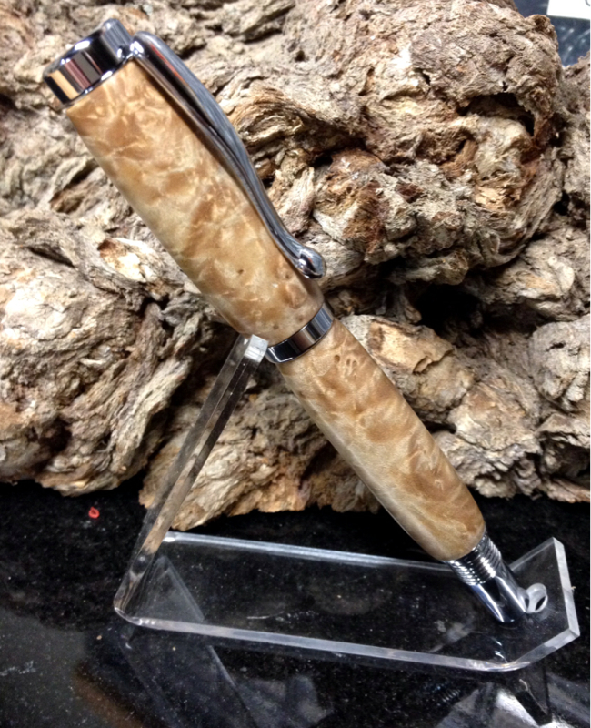

I turn a lot of stabilized blanks, they always finish very well. Did some buckeye burl yesterday that, after the finishing cut with a razor sharp skew, had no need for finishing. Has a completely different feel than unstabilized wood.
CA is still my choice for a finish on wood; It can be worked in so many ways for gloss, matte or something in between.
Here's a pen I did with no finish added.

That burl looks like a good choice for stabilizing. Nice job on the buffing Dan! How does it "feel" (I know, very subjective!!!) vs a CA finish?
It defiantly has that silky feel. It feels great. Different than ca. But I happen to like how ca feels too.
I guess the lack of high gloss is a good trade off for the durability and lack of potentially problems with ca.
