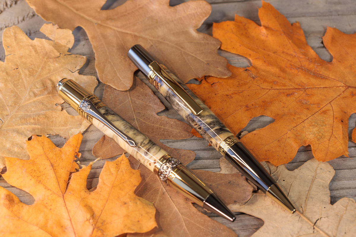

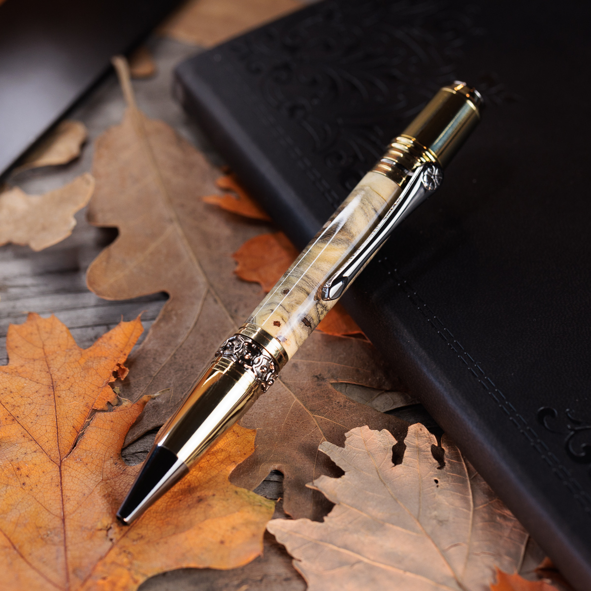

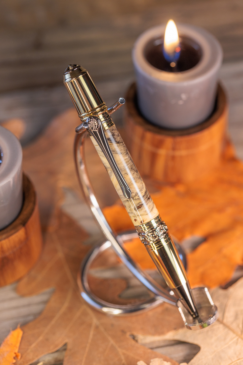

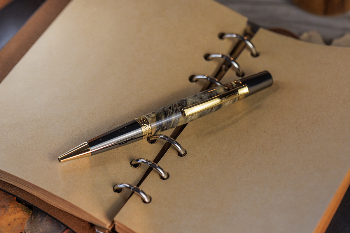

These were a couple of re-dos. I did not like the materials I had originally chosen for the barrels, so I disassembled them and started looking for a blank that would do them justice. I eventually found this buckeye burl blank that was just to die for, and was the PERFECT match for the gold and gunmetal on these two beautiful kits.
Ballpoint Pen - Finial Twist - Cirque - Buckeye Burl - Gold and Gunmetal - 12.jpg

Ballpoint Pen - Twist - Elegant Sierra - Buckeye Burl - Gunmetal and Gold - 2.jpg
Been working on my photography setups. Lighting, this round. New lamp with 3000k, 4500k and 6500k temperature settings that is designed kind of like a tall loop, produces some interesting reflections on pens like this. Which I think helps bring out some of the details in the metal parts, like the bands and clip on the Cirque.

Beautiful pens! Your photos are very well thought out and look great! Buckeye Burl always looks great as it's always different and when turning it down there's always good surprises.
One of these days I am going to get into photographing my works better. may need to upgrade the camera too. It is on my long list of to do things. Nice job on both the pens and the photos.

I love Buckeye Burl; I love your turnings; and I love your photos!!! 👏 👏 👏 Well done.
Buckeye is one of my favs also. So much character. Your pens look Very elegant.
Nice work!
Really nice Jon. I agree, the Buckeye Burl is perfect for those!
Aye! Buckeye Burl is some of my favorite wood! In the past I have not necessarily chosen companion hardware so well. I think these two were perfectly made to match with this buckeye... This was a really intricately detailed piece, too, and it didn't quite look it from the outside. I think that's one of the things about wood I love the most...you often just never know what you are going to get! I turned a vase in 2021, one of my first, from this piece of maple that looked really janky and nasty on the outside. I picked it, because it was one of my first vases, and I figured if I screwed up it wouldn't matter given the wood. Well, once it was turned, it had the most beautiful internal staining, these little brown flecks spattered about one side of it, a slight bit of spalting in one area, and it kind of patchworked through a few different colors. In the end, the wood was truly beautiful, but you would have never known it from the outside!
Excellent all round, Jon.
Another vote for Buckeye Burr!!!
Looking forward to your photography thread...I need something like that.
Wow! Beautiful pairing, great eye for matching the wood to the kit. Your photos are beautiful as well. I'm loving that Buckeye burl, hmmm 🤔

This particular burl was not originally. I did, however, use GB Ultra Thin (green label) to stabilize the blank originally for trimming down to size, then as I turned it, I flooded it a couple more times. There were two cracks in teh original blank, that I am pretty sure would have resulted in the blank flying apart during turning if I had not done this. I need to get a new vacuum pump so I can properly stabilize blanks, as I have quite a lot that really need it.
I have worked with other buckeye burl that was stabilized, and its a dream to work with. That said, I do think that the stabilization resin, may not be the best for bringing out the chatoyance of the burl in the long run. Stabilizing resin doesn't seem to be quite crystal clear enough to truly do chatoyance justice. For some woods, that doesn't matter, but for buckeye burl, I think in the end it does? The chatoyance on these two pens is exquisite.
