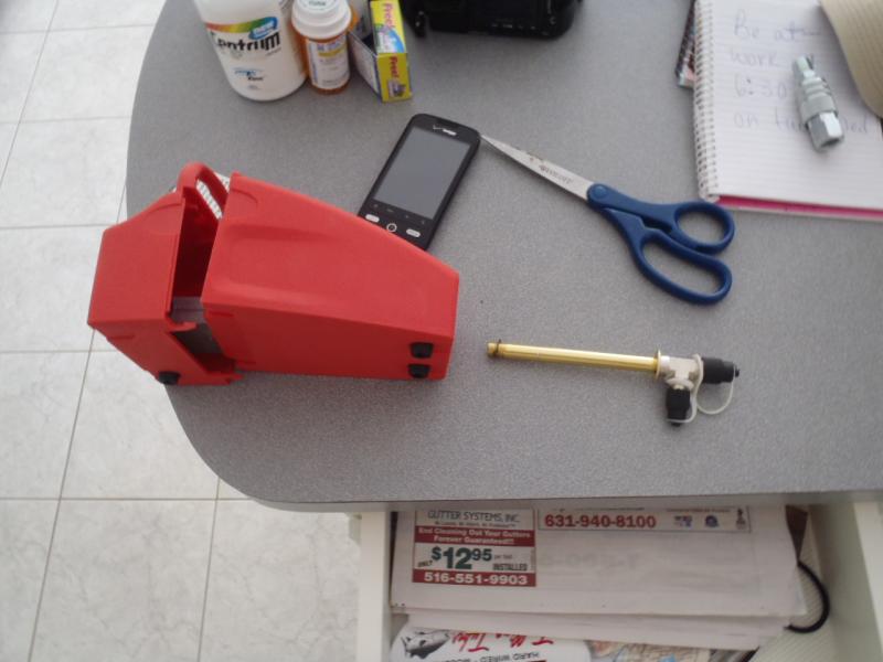

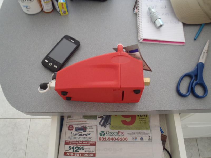

mine is arriving tomorrow so i can't say for sure, but as it comes, it should have a 1/4(or 3/8) NPT for you to screw in your air fitting. the other ends are vehicle refrigeration hose adaptors. 134 and 112. i think it would be a PITA to get those fittings back to NPT. will let you know in a few daysd and can take pics if needed

I have one of these that I picked up for $1 at an auction. Why does everyone say to strip out the Venturi block? Doesn't it work as-is?
it just came. 1/4 female NPT on one end for your air line in. the a/c adapters are attached at a 1/8"NPT nipple that screws into the otehr end of the block. i tried real quick and couldnt get the adapters to come off the nipple, so i'm just putting a nipple and bushing into the end of the venturi. here's pics. all that's in teh housing is the venturi block, so i stripped it out to get the extra clutter gone.
first pic shows it as is outta the box. second shows the nipple with adapters removed.
I get it now, mine is bit different, but will still require some adaptation.
