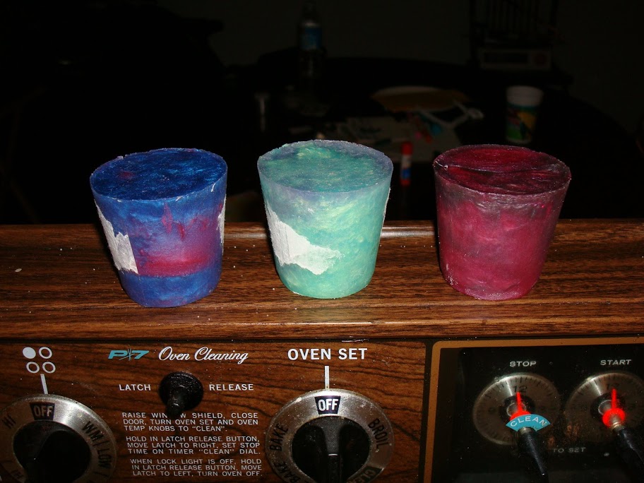

The best molds I have found for casting stopper blanks were actually the leftover individual serving cups from Kozy Shack rice pudding. They are a little wider than the pill bottle and taper more but do have the center dimple for drilling. They are polypropylene and not much, if anything, sticks to them. They are thicker than the snack pack pudding cups and seem pretty durable. I have cast alumilite in them with no release agent and one firm tap upside down and it popped right out.
And it was so much fun emptying them!:biggrin:
