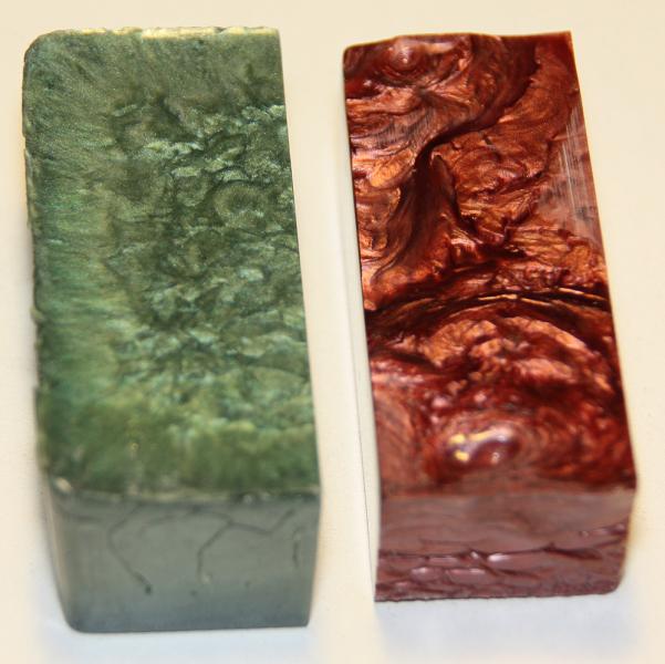

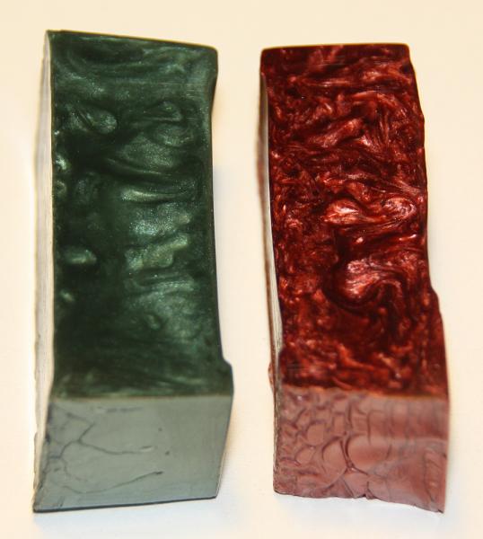

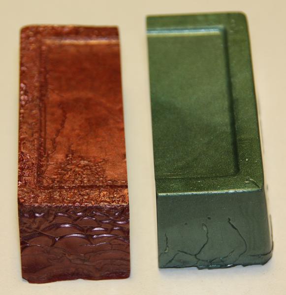

Here are some pics. I cut the blanks and polished the inside so you could really see what they looked like.
I was preparing for the Christmas themed PITH. The green PR cured on it's own for the most part. The red was the one that I kick started with the "heat lamp"...
The first pic is the bottom, which pretty much looks the same on both blanks. The second pic is the top, where you can really tell the red one was in motion when it cured. And the last pic is the "inside", cut and polished.
