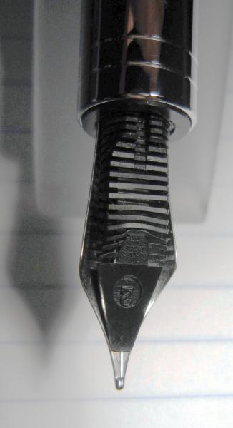

I'm new to fountain pens, just posted my Pristina to SOYP. I've searched the library and info on other sites but need some advise. Based on some info in the library or on Classic Nib site the feed is not in the correct position on my Bock nib. it looks like the feed is too far forward. Sometimes the ink doesn't flow at the start of writing.

1) Do I need to adjust the feed?
2) Does the Bock nib/feed separate from the section?
2) If so, do I just keep pulling until the feed/nib out of the section?

Mike, the Pristina feed will pull out just keep tiring, both the Pristina and the Roman harvest are tight fits compared to others. Looks like from your photo that the nib and feed are in proper position but if anything try bringing the nib just a smidgen (thats a technical measurement) forward.
If the feed is not extending past the side of the nib and if it writes well I probably wouldn't futz with. It is not that far from ideal which is just basically a "it should be in this area" type of thing.
It may just be the angle of the photo, but it appears that the (senior moment) tip of the nib is out of alignment. What is the name of the very tip? From the photo on my monitor the two sides look to be one above the other. of course I am old and my glasses are from Wal-Mart.

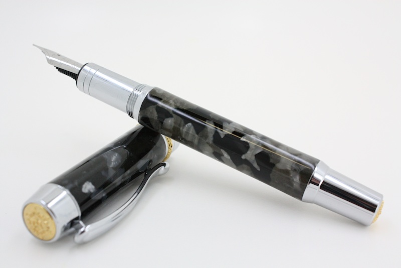

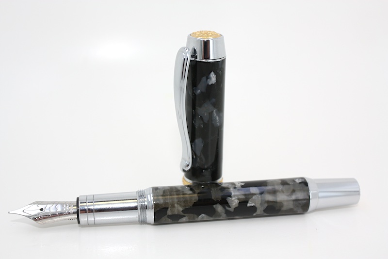

Roy (aka Oklahoman) offered to check my pen. He found some issues, fixed them and now the pen works great. The ink flows smoothly, the nib isn't scratchy. I have my new daily writer.
I added a couple photos that are a little better.
Thanks for all your suggestions and comments.
